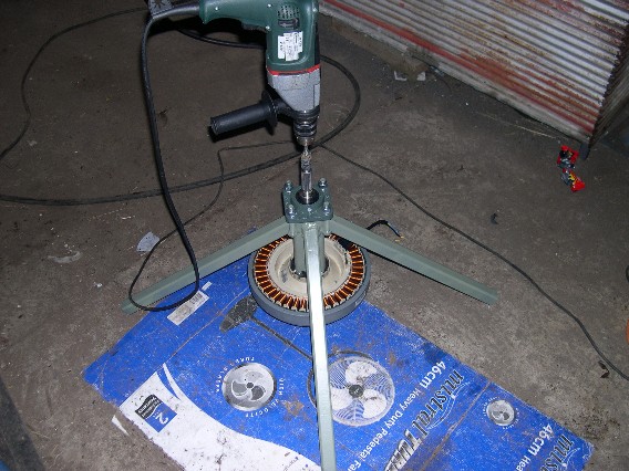

Hallo i'm pablo an live near ballarat vic and have been very interested in the f&p alternator for a vertical axis wind turbine.  I want to use the portable windturbine to drive a paddel aerator and a small pump without the use of a batterie to manage damns for aquaculture reasons and water quality reasons.  I'm donig some mech engineering at uni and had lent a optical tacho to test the motor/alternators preformance here is a photo i used a drill attched to the shaft to power the alternator and could hold it steady plus or minius 10 rpm.  I also loaded the unit and due to the current being propotional to the reacting torqueorgue found that a 100w laod will need a degree of starting torque.  The quetion is... i have now rewired the alternator to the 7 pole and have been driving a 80w thermofan for a paddel aerator and need the load to come on at about 2 volts or about 50 rpms and a universal voltage switch kit from jaycar electrics might do the trick however i'm not sure if it can hold a 15-20 amp current.  Has anyone used some kind of voltage switch to eliminate high load starting?
And i must thankyou for all your info on this sight note the farmiluar redesign from one of your models here is a better picture.
