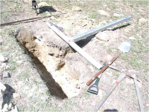

Hi the "deadman" part of the guy anchor assembly is the horizontal part that attaches to the angle strut that connects to the guy ,,via a turnbuckle.
I dig a trench ,,around 3-4 feet deep (i'm in fairly rocky conditions) and bury the deadman with rocks ,concrete,backfill,,Etc..
Here's a layout of the steelwork before I lowered it down ..
