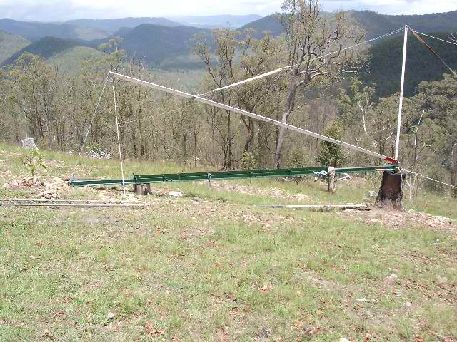

This one is tricky(for me).
The base block and attachment steelwork is fitted for my mast. the land is sloping quite a bit , forward and aft guy anchor points are not a problem.
Now ,the big question is , how do I calculate accurately the side "point-of-attachment" length from the centre ,say 30 feet out from centre  ?.  The high side is no problem as the ground is level at this point-just drive a peg in at 30 feet.
The other side of ground falls away --is there a easy way to accurately measure and peg the point -of -attachment for this side ?
any takers?
Thanks Bruce

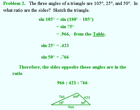

Yeehaw, trig isn't as hard as I remember it!, theres a massive amount of info on the net.
If my understanding of your problem is correct, then I've found a nice little way to work out the ground length, thats if the mast/wire angle is known, and the mast/ground angle is known, and the mast hight is known.
It's simple ratio's:
The mentioned table is here:
http://www.themathpage.com/aTrig/trigonometric-table.htm
So, for this example, if the 766 is the mast and the 423 is the ground, then the ground length is 423/766 = 55.2% of the mast height. Nice.
to quote the website:
'The sides of a triangle are to one another in the same ratio as the sines of their opposite angles' - the Sine Law apparently!
Ok, hope that helps, sorry for the multiple posts, and all the thinking out-aloud!
