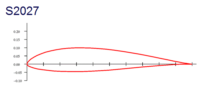

Hey,Mac. I'm going to try and put some of your coaching into practice (MOD-I will open post as if it works some of references may be of general interest , altho "heresy" ). Damn!! Did a google search to find the http of an article I have in front of me called "Economic Feasibility of Wind Turbines for individual households " and google can't find it (despite the fact I got it from the web). Tried Googling the Authors ( Claude Guillaume , Sandra Algazze and Emmanuel Duc ) that did n't work either so you're on your own.
Anyway this looked like a University thesis , relevant as they were not after gullible venture capital money. It looks to me very well written and scientific and is fully referenced. I quote from the introduction ..."so Vawts are potentially more efficient than Hawts, and also cheaper using straight blades with fixed pitch angle" Another quote "..the H-Darrieus design which uses straight blades , usually called SB-VAwT ...demonstrates the best ratio between the swept area and space requirement as well as the lowest cost to manufacture blades. Moreover the Reynolds number remains constant along the blade length."
If anyone more successful than me at finding this article its worth posting the reference as they test several NACA profile blades and conclude ..."in all computed configurations ,airfoil s2027 , gave the best results."
Somewhere I obtained and printed the foil shape and coordinates for S2027 and when I get off-line I'll try and dig it out and have another shot at finding the article I mentioned above. Then I can practice my http referencing .

Posted: 12:44am 12 Oct 2010
this is the airfoil mentioned above.
Gordon.
