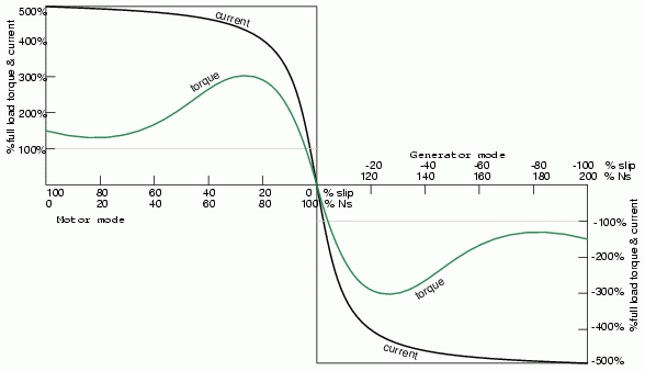

The relationship is far from linear - when grid-connected, at 1450RPM it would motor...at 1499 RPM it would motor... at 1501 RPM it would generate.... at 1550 RPM it would generate even more. The term you're looking for is 'slip'. Googling that term will answer many of your questions.
The link below also provides a wealth of information:
http://www.allaboutcircuits.com/vol_2/chpt_13/7.html
You normally operate at maximum -2...-3% slip (motor) or +2...+3% slip (generator), or roughly between 1440-1499 RPM as a motor and 1501-1550 RPM as an alternator.

The other thing that complicates it a bit, is that the torque to slip is effected by the rotor bar resistance for a given power rated motor
The higher the startup torque design, the less resistance will be in the rotor bars. So compressor type motors which need high start torque will have very low resistance rotor bars, and so the torque changes hugely for a small change in slip.
Centrifugal pump motors which need very little start torque will have more resistance in their rotor bars, and seem more forgiving ... and so a little more likely to break away.
What this means is that the motor you choose will have a bearing on how you drive and control it.
