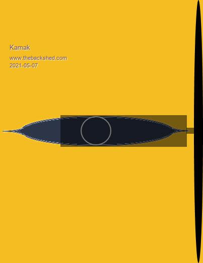

Shape the tower profile like this.
Just from the nacelle down to the length equalling the rotor's radius. More like a skirt of fabricated sheet metal that goes over the tower, and yaws with the turbine, as it follows the wind direction. Making the air pass around the profile with more laminar flow.
