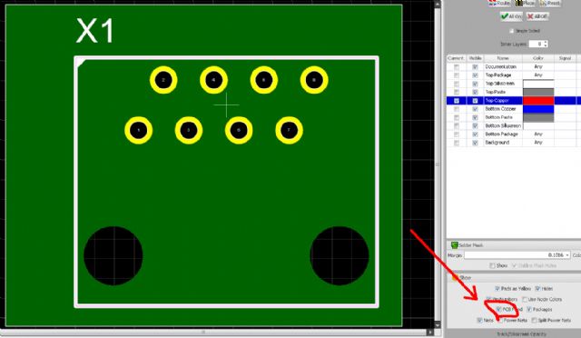

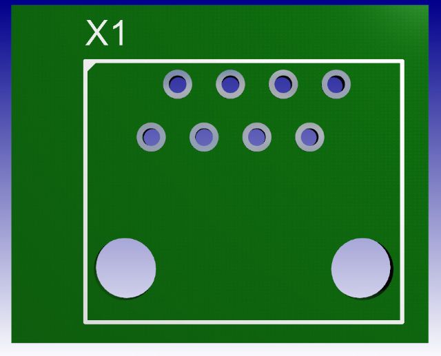

This is a part I created with two mounting holes.
The holes are there in the footprint in the library viewer but do not show on the PCB.
2016-08-27_015615_RJ45.zip
Posts: 2982
Posted: 08:46pm 26 Aug 2016
Hi All,
If you select PCB filled the holes will show.
Also you can always check the 3D view

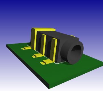

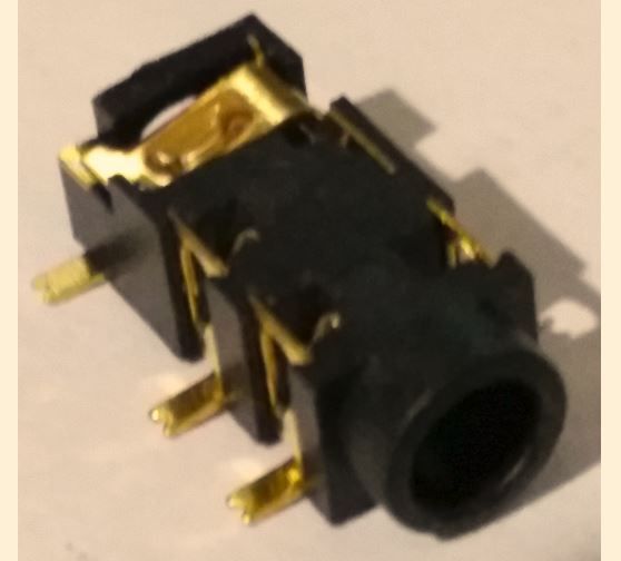

I managed to put holes for the pcb guide, in ok.
Quickly whipped up an stl model to add for the package. Scale was a bit off.
Had to import the stl at 0.0155 scale. Created the model using real world dimensions. Got it to fit eventually.
For Comparison. The Real One.
Thanks again for all of your help.
