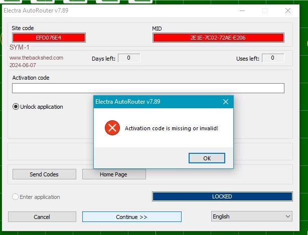

I have just created a PCB using dex but now I go to autoroute the board they want a lot of money for the router. Is there any way around this?

DEX used to use a free version of Electra, you are probably been sent to rut it.

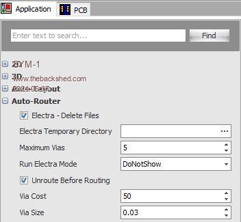

This was withdrawn some time ago and DEX has its own auto router. Under Settings/Applications/Auto_Router there is a checkbox Electra-Delete Files checked on my system. Also Electra Mode = Do Not Show.
So if you stop it trying to use Electra its should use its own inbuilt router.
(Would depend if you have a late enough update that has the native Auto-Route.
Gerry
Just confirmed, if Electra Mode <> Do Not Show it will try to run Electra, which is not free. So set it to Electra Mode = Do Not Show.

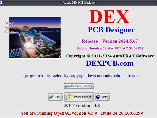

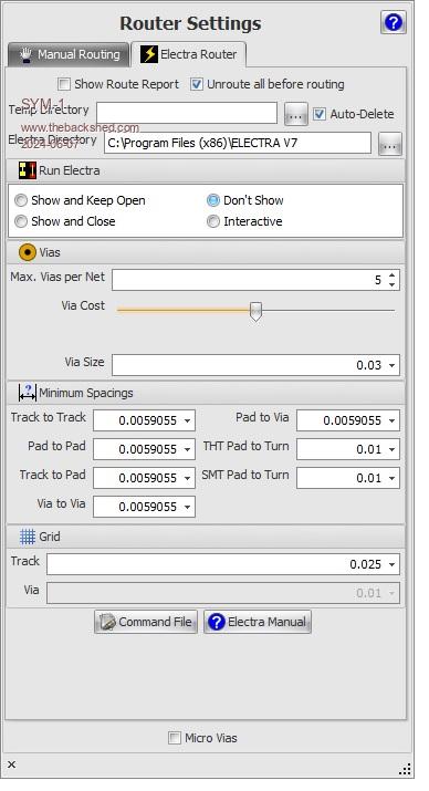

I still can't seem to autoroute.  Here are my settings pages.  I note that I do not have any option tab for Ïnternal Router  on the Router Settings page.  Is there any way around this?

I may have given you incorrect info here. I think I may have the free version of Electra initially distributed with DEX installed and it is just hidden with the settings indicated , but is still actually doing the auto route.
Electra is no longer included or even available as free I think.
I did have the impression Dex has developed it own auto router but this may not be the case.
Gerry

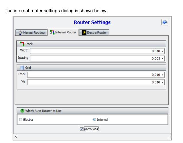

Page 702 of the latest downloadable manual has internal as an option but like SYM-1 I can only see manual or Electra tabs on mine.
Here is a screen shot from the manual, (sorry that doesn't help)

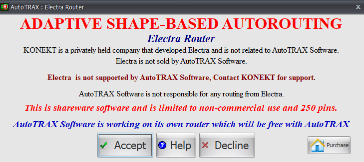

I have a clean copy of DEX that I installed 12 months ago.
No updates since then (Don't use it much!) and now my 12 months has expired.
This is what I saw when I tried to autoroute:
It suggests that he is still intending to provide his own router.

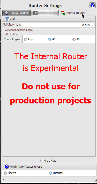

This is what I get when selecting Internal Router by  expanding with the little arrow,
mine last updated 27/3/2023.

Download the latest version.
The author said he has reinstated the internal router, but to be aware it IS Experimental at this stage.
