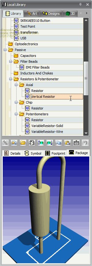

Because of the above I have a lot of through the hole components and will use them where sensible. I would like to make Trax mount the resistors vertical to save board space but cannot find a way to do it. Can the gurus point the way or should I just switch to smd or lay them flat?

You can find some vertical resistors in the parts library
F4 H7FotSF4xGT

Disco4now - Now why did I not find it there. I searched, tried help - grrr.
I knew it would be there somewhere. Thanks.

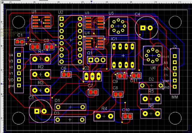

Success. I managed to squeeze it all in and keep the 3"x2" size I wanted. Learnt more about AutoTrax which is good. Starting to get the feel and how to get it to do what I want.
I am sure the experts will see some bad things. Hints welcome.
