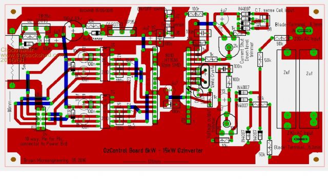

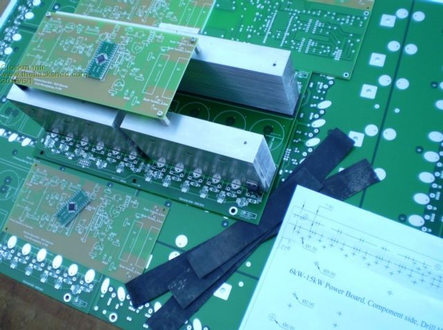

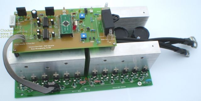

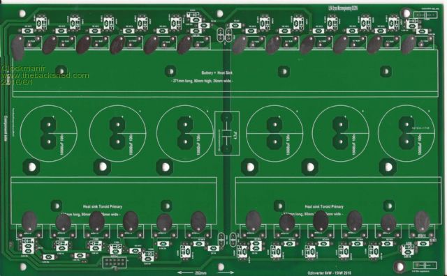

So I re-did a 'New 6-15kW Power Board' to match the 'New OzControl Board'. As you can see in the Photos we Now have are Own 6-15kW Inverter PCB Boards
The New Power board is a double sided, with double thickness of copper ie 70um, and it just fits on a sheet of A4 so its possible for home etching.
