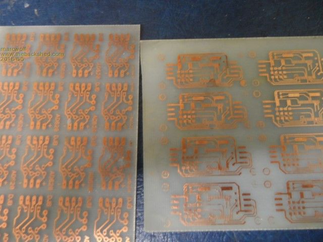

Posted: 10:09pm 04 Jun 2016
  plover said   marcwolf
What about showing photo of a couple of boards as encouragement for people considering such route?
Most of my boards are with other people, or populated. However here are 2 boards that I made. The one on the left is for a small OP Amp with trimmer resistor, and the one on the right is for a friends project..
That was a board I discarded because of defects however you can see how fine the prints can go. My laminator was not hot enought when I ran that one.
