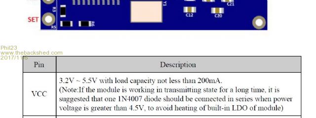

Posted: 11:07pm 05 Nov 2017
No Channel switching in my case.
Do wonder though about the mention of lowering supply voltage in the documentation.

Posted: 12:21am 06 Nov 2017
i've only ever powered them from 3xAA cells = 4.5 volts. an LDO can then nicely brings this down to 3v3 for a micromite.
bear in mind that the HC-12, when operating on the 'legal' channels (1 to 4) is making use of a shared set of frequencies intended for remote control applications. as such you should not be transmitting continously, but just sending short bursts of data with reasonably long gaps (of a few seconds at least) in between.
any continuous transmission may, for instance, block nearby wireless garage door openers from functioning correctly. one should always try to be considerate of other radio spectrum users when designing with an HC-12 or similar 433MHz devices.
rob :-)

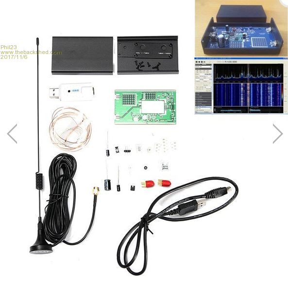

Posted: 01:09pm 06 Nov 2017
On a side note & I've mentioned this in an earlier post,
for those who don't have an (Expensive) RF Spectrum Analyser, (Like me),
a USB TV dongle is worth investing in as a Spectrum Analyser.
Even better is the SDR (Software Defined Radio) kit reviewed in this months Silicon Chip.
It's $30.00 on Bangood.
With my SDR dongle here I can see all of my 5 other 433MHz devices, along with the HC-12's.
Well worth the $10.00 a USB dongle only, but the $30.00 kit offers a few small advantages.
PhilEdited by Phil23 2017-11-07
