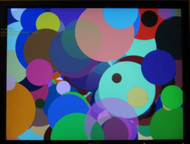

Please find attached version 5.4.14
2017-10-30_185432_mmbasicjessie.zip
2017-10-30_185448_mmbasicstretch.zip
This includes the ability to use a conected HDMI display as a LCDPANEL
OPTION LCDPANEL HDMI
See the video to watch GUI test running on a 1600x1200 HDMI display
The code automatically reads in the display size and MM.HRES and MM.VRES are set automatically for you. The display is in full 32-bit colour (RGBA).
