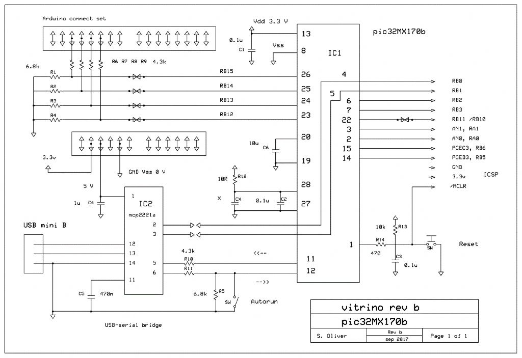

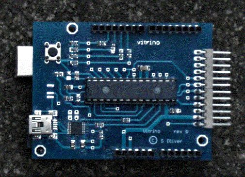

I have a few of these spare if anyone wants one.
They are fairly generic, and lodge on an arduino uno and in turn
hold a parallel LCD shield although the LCD shield is not necessary.
The arduino supplies power and connects via a spi client (slave),
drpending on what the ino specifies.
The pic pins on the rhs have ICSP, digital and analog signals, I have
used them for an extra bit-bang spi port, auxiliary serial port
for GPS stream, two analog signals etc.
A remote 4-wire spi connection works ok with care wrt noise/grounding etc.
(ed) ie, the pic board itself can easily be separate instead, driving
the lcd/uno client via a cable.
schematic
Bill of Materials - Vitrino rev b
Resistors
R1-R5 6.8k 0805
R6-R11 4.3k 0805
R12 10R 0805
R13 10k 0805
R14 470R 0805
Capacitors
C1-C3 0.1u 0805 ceramic
C4 1.0u 0805
C5 470n 0805
C6 10u 1206 Low esr ceramic
CX X 0805 optional filtering
Hardware
PCB Vitrino rev b
switch pusbutton momentary make
(switch) miniature slide SPST optional for autorun
socket USB mini-B smd
headers arduino stackable pin set
ICs
(IC1) pic32mx170b sdip
(IC2) mcp2221a soic

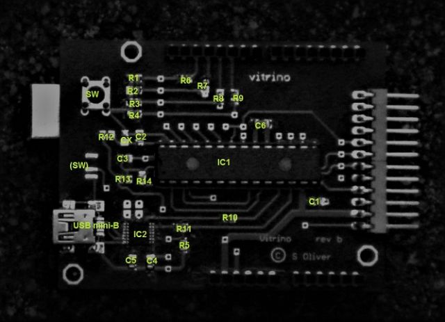

(ed) there are more photos etc on the other thread
The resistor group near the top are the connection to the 4
arduino pins (D13,12,11,10). It is designed to allow the pic
spi hardware to connect as an option with links, alternatively it is
very easy to put in a bit-banged spi routine in C that can
can use any of the digital i/o pins. So one spi port can drive
the uno/lcd and the other can access sensors etc via RB0 etc on the rhs.
