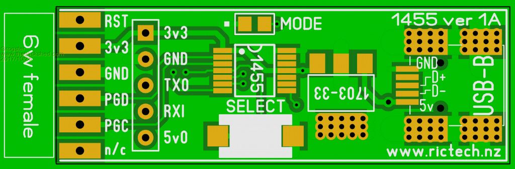

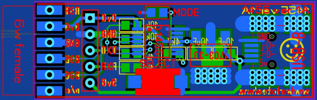

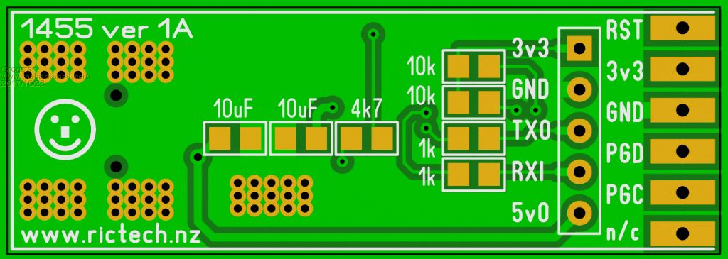

Here is my latest creation:
The board size is 43mm x 15mm - slightly smaller then an Arduino Nano.
The board incorporates the wonderful 1455 USB interface in a TSSOP chip, 3v3 regulator, USB socket, ICSP connection, serial connection, 3v3 and 5v outputs for powering external things.
The idea with the ICSP is that you solder a 6-way female header to the top or bottom of the board, and reinforce that with some epoxy if you feel the need. The edge-connector pads also have standard 2.54mm holes in them if you wanted to solder wires on instead, or perhaps make use of a long-legged female(header).
This is designed to be an expansion of the ASCII ICSP by Rob, that used the Nano module piggy-backed on an adaptor board. As with his module, this one plugs directly into your PIC32 project ICSP header.
What I really love about the 1455 interface is that not only is it your ICSP, but it also works as a USB-Serial adaptor too, so you get both in the one little chip.
The 1455 is faster to program PIC32 chips too then the Arduino units using the same pic32prog.exe programmer.(with no disrespect to the ASCII ICSP)
Please note that this is not quite finished yet - I need to provide PGD and PGC pads for initial programming of the 1455 chip....
I will be getting some of these when done though, so it might appeal to others.
I will post the Gerbers here when I am done, so others can get them made if they want. Apart from the regulator, which is SOT-223, all other components are 0805 size.
EDIT: Oh, and yes - the USB D+ and D- kinda need to be done at some point....Edited by Grogster 2017-10-29

@G
Mode LED?
panky
Posts: 10075
Posted: 04:39pm 27 Oct 2017
Yep. On the 1455 interface, one LED is used, and it can indicate different modes of operation, as well as doubling as a power-on LED too.

Posts: 2552
Posted: 01:39pm 29 Oct 2017
i'd strongly recommend providing for a pullup on RxI. i believe this should be a part of all 1455 designs as otherwise random noise can be picked up by the 1455's uart.
rob :-)
Posts: 10075
Posted: 02:58pm 29 Oct 2017
Good point. Will do.

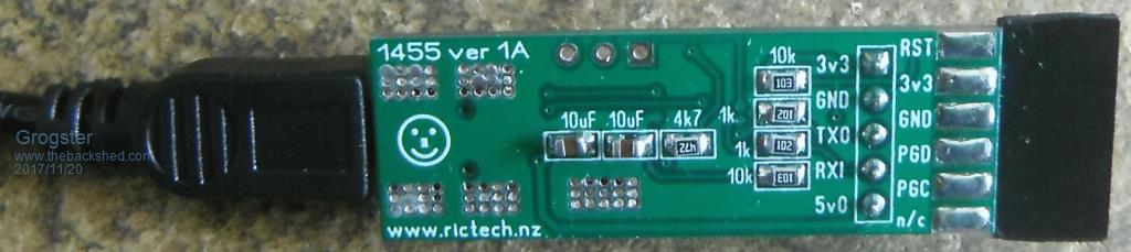

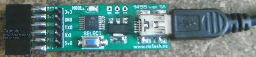

Posts: 10075
Posted: 04:32am 20 Nov 2017
UPDATE:
First one!
All programmed and working like a charm. This version of the PCB does away with the 10k pullup on pin4 of the 1455, and places it instead on RXI as per Rob's earlier suggestion, and that seems to be working fine.
Loopback test to GFXterm works fine, but I have not yet used it to program a PIC32 chip, but plan to try that tonight.
The 1455 interface is MUCH faster then the Arduino Nano ASCII ICSP - perhaps Rob can elaborate on why that is, but there you go. Not raining on the ASCII ICSP that uses the Nano though - it has served me very well.
If anyone is interested in a Constructor's Pack for this, please post here and I can upload a zip file with Gerbers, drill data, layout file and layout viewer.Edited by Grogster 2017-11-21
