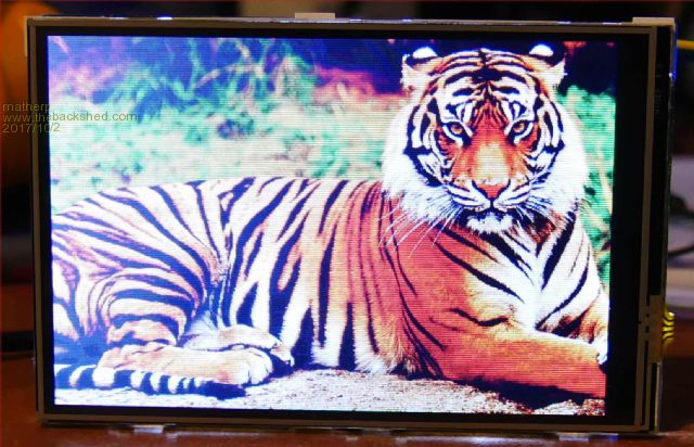

The excellent 480 x 320 IPS 4" ILI9481 displays are directly supported by the MMX and Pi-cromite.
I've now created a loadable driver to use them on the MM2 and MM+. See this thread for connection details.
This was done specifically in preparation for the Micromite pHAT compatible PCB but the display can be used with any Micromite if appropriately wired.
The MM2 version supports all the normal MM2 graphics commands and TOUCH can also be enabled using the normal option command. The MM+ version also supports all the GUI commands and LOAD IMAGE as seen above.
The driver should be stored in the library and enabled with a command in MM.STARTUP
ILI9481 CDpin, RESETpin, CHIPSELECTpin, orientation
valid orientations are : 1=landscape, 2=portrait, 3=reverse landscape, 4=reverse portrait.
Wiring of the touch and SPI pins is exactly the same as an ILI9341 display as detailed in the MM2 and MM+ manuals

Posts: 10075
Posted: 12:18pm 17 Oct 2017
What effect does using one of those LCD's with the shift-registers in front of the actual controller so you can use it on SPI have on the update speed etc?
Obviously, your C-function is written to get around that speed problem you would most likely have from within BASIC, but can you give some examples of load-image time, and just general refresh rate?
I'm just curious, as these type of screens are much easier to wire up then the parallel ones, but also much bigger then the standard SPI ones we have been able to use thus far.
I know and expect it will be slower then the parallel interface - it has to be by it's very nature, but I am still really interested in some numbers.
Posts: 12083
Posted: 10:08pm 17 Oct 2017
These screens are 480x320 RGB565 so twice the pixel count of the ILI9341.
The time for a CLS on the MM2 @ 40MHz is 123mSec
480 * 320 *16 / 0.123 = 19,980,487 bits per second which given the SPI clock is running at its maximum of 20MHz means we aren't losing many cycles
This is achieved by the CFunction running SPI in 16-bit enhanced buffering mode so that the code can keep the SPI channel fully loadedEdited by matherp 2017-10-19
