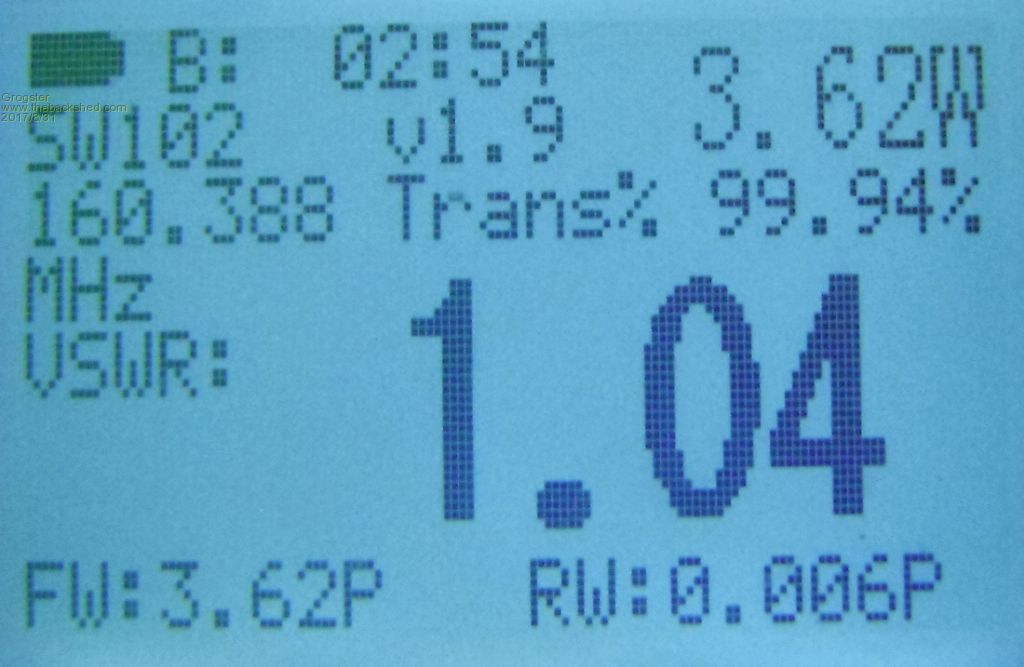

The next thing is a digital RF power/SWR meter. This unit supports 100-520MHz range, 120W capability, frequency counter, SWR meter, transmission efficiency, forward and reverse power displays, and built-in rechargeable battery(charge via mini-USB). Many parameters can be changed in the built-in menu. US$48.50
Surecom digital RF/SWR meter
Here is a photo of my using it to measure the output of a paging transmitter(into a dummy-load):

The power meter has received a technically rigorous, unfavorable review to which I'll post a link later. It's also demonstrated on youtube (driven by a Wouxun).
If it were more like $25 or $30 I might be tempted to buy because in addition to power it has a not bad little frequency counter built-in. Very portable.
Curious, Grogs, if you've been able to compare its power reading with a calibrated instrument.

The screenshot shows exactly the right information compared to my analog SWR meter, but that is not a calibrated instrument. The frequency as stated on the LCD is close enough - 160.3875MHz was the transmit frequency. The figure of 160.388 could be an 'Error' or could simply be the unit rounding up. Output power is actually off a little when I do a comparison. 4W FWD, but the unit is about 400mW out. I guess that depends on how specific you want to be, and bearing in mind what it does for the price, I don't think you can expect NASA standards on this thing - more of a ballpark indicator of what is going on, which is still useful. A 400mW power reading error is too high IMHO, and would possibly make the unit useless depending on how accurate you wanted to be. There is updated firmware for these, but you have to send it back to China for them to program it - probably not worth the effort.
