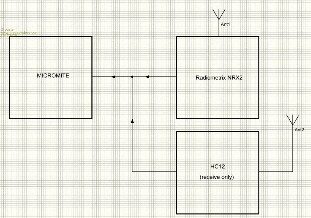

Perhaps a diagram would help. This is what I am trying to do:
The Radiometrix receiver unit is what I am using now. This works fine.
I want to add an HC12 as a receiving node, transmitting HC-12's at the other end which will send exactly the same data packet as the Radiometrix link does now, so I need the Micromite to be able to respond to either one, but not have either receiver upset the other with respect to their data lines.
Due to transmitting node retries, data collisions are not an issue.

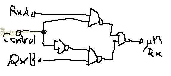

Hi Grogs,
Another idea is if you can derive a CONTROL signal anywhere in your circuit which can determine if one is active, it can be used to drive an A/not-B selector using 74C00 or similar chip as per the following picture (assuming it uploads OK)
Sorry that didn't work try this
PhilEdited by flip 2017-08-29

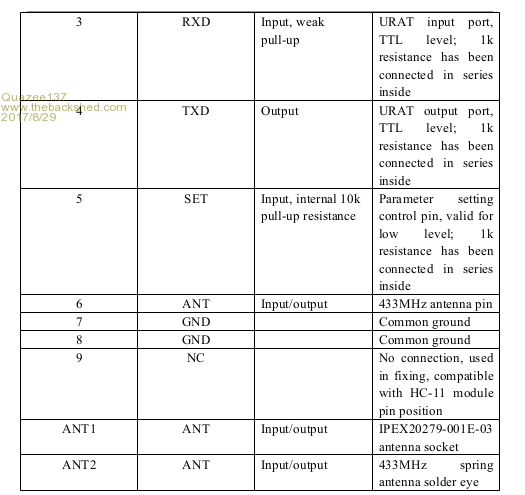

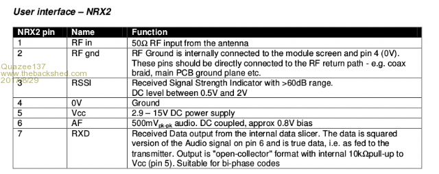

Posted: 02:33pm 28 Aug 2017
From the data sheets it looks like you can just hook them together.
As the NRX2 is OC with pullup and the HC12 has a 1k inline.
and
You said data collisions are not an issue.

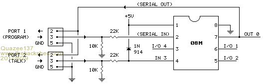

Posted: 09:45pm 28 Aug 2017
If your not using all the PICAXE pins maybe this will do.
2nd serial in on 0M82
This too maybe of use
Daisy Chaining 08M Chips
