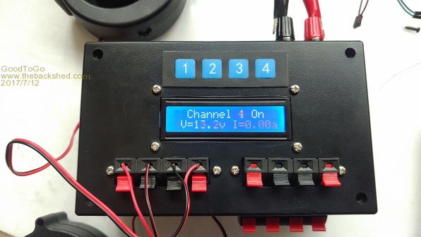

Features
-4 separate 34VDC-12VDC supply 'Channels'
-I2c relay control
-temp monitoring
-variable fan speed control using PWM depending on temperature
-fan supply uses all 12v channels via diode separation
-wireless comms using HC12
-I2c 16x2 LCD display for local monitoring
-LCD Display backlight timeout
-4 local switches for relay on/off/reset/LCD backlight control
-Can run independant of GUI monitoring unit

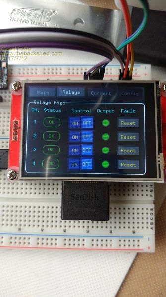

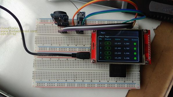

Also, the GUI monitoring unit features
-Wireless comms using HC12
-Overcurrent trip points adjustable
-'Auto' trip point adjusting routine
-SD card logging of all data - time stamped (RTC)
-various displays showing power supply/relay status (OK, TRIP, FAIL)
-GUI LED indication of status (Green ON/OFF, RED for stuck relay ON)
-Voltage/Current/Max Current/ Startup Max Current displays
-Full control of 'slave' power supply unit(s)

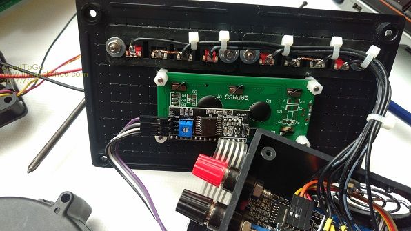

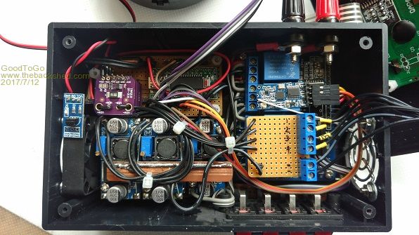

Inside the box:-
It's a mess.
It's amazing how you think you lay something out nicely, but once you throw the point to point wiring in it rapidly becomes a nightmare!
Most modules are ebay sourced.
-relay unit.
-2x LCD I2c modules. (One converted to drive the relays)
-4x INA219 modules (stacked on top of each other) to monitor voltage/current
-DS18B20 temp module (on top of fan)
-HC12 module with a straight wire for antenna (might go back to the spring one)
-Fan driven by TIP120, controlled by the MM
-You-beaut Explore28 module hidden in there somewhere as well
-5x Buck power supplies. (2x2 stacked on top of each other providing 12V, one by itself supplying 5V for MM)
-16x2 LCD module
-Stick on Membrane switches
As far as the GUI side of things goes, well, it's just a MM+ LCD backpack, coupled with an RTC module and a HC12 module.
