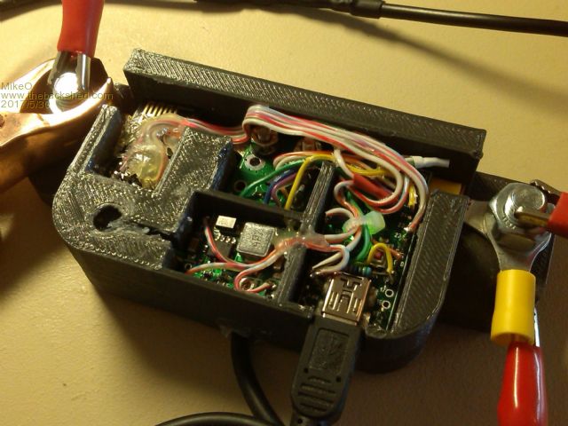

Photo shows 3D printed enclosure , Battery terminals, from left ESP8266 wifi, ASC711EX current sense, Explore 28,bottom left Temp sensor and DC to DC PSU.

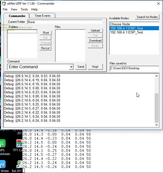

The photo shows a Windows app displaying data stream via wifi (UDP) and below is the USB serial. The Windows app I wrote some time ago to communicate with ESP8266 UDP protocol, I will probably write a more specific app to communicate with the Battery Monitor for windows, I am also trying to learn(get to grips with) B4A so I can make one for Android phone which would possibly be more convenient. Alternately another uMite backpack with LCD display could be used displaying the serial data.

Really nice job Mike - amazing how neatly a 3D printer can tidy up a heap of modules! What are the dimensions of the 'box'?

Dimensions are 120 x 50 x 30mm

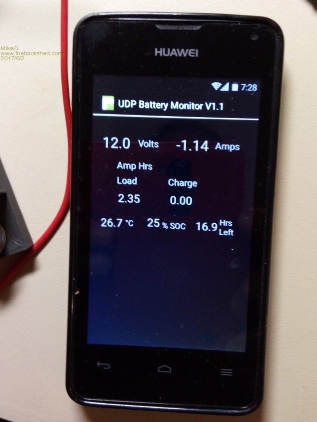

Update, I have written a very simple android app now running on my phone to receive the data stream from the Battery Monitor. This has other possibilities as well i think.
