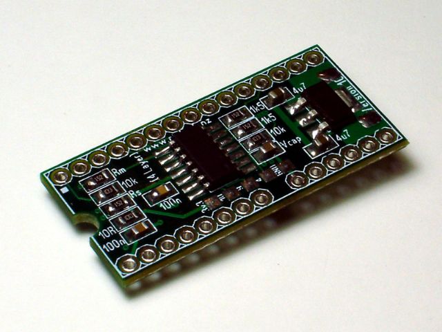

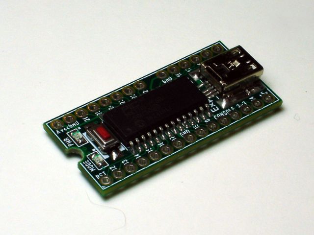

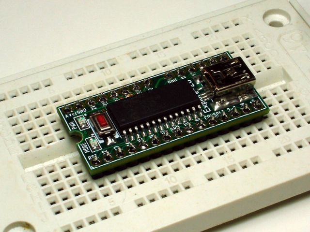

the next version of the explore-28 module is now available, using a SOIC packaged MX170 instead of the oh so difficult to solder QFN. switching to a SOIC package, along with some layout tweaks, has greatly simplified construction.
both WhiteWizzard and Grogster have units available for order on their websites. and hopefully one of our american friends will step up as a USA supplier.
Here is a slightly expanded blurb for the 1C units:
2017-05-22_161437_E-28_v1C_blurb.pdf
and here are a few photos:

I will have to concede to MicroBlocks - he was right - the QFN was more of a pain in the arse to solder then we thought. It was do-able, and actual soldering of it was easy enough, but it was way more time-consuming to align and stick down then the SOIC etc. MB - If you are reading this: point taken. Don't design with QFN, unless you have a reflow oven!
The 1A's that were produced all worked fine bar one unit, as far as I know, but the SOIC will also be that much easier to check over the QFN too.

Grogs,
That is a nice ... No!! Beautiful looking board there.
Well Done!!

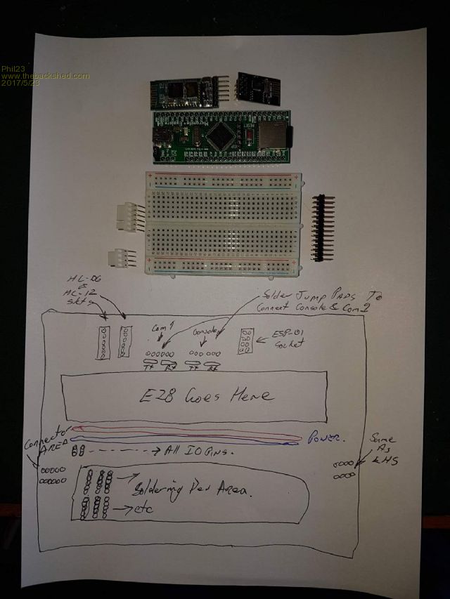

Great little module Rob,
Plan on getting a few.
Can I suggest you an Grog discuss a development board to go with it?
I know that's against what the purist's use, but for the backyarder who wants to just solder his project up it's a great thing.
An afternoon work to have a finished project.
Scribbled this up, which shows an E64 as the example.
The user could add any 2 of the 3 popular wireless modules;
ESP-01, HC-05 & HC-12,
either as console or coms, they just bridge some pads & fit the modules.
Have a bit of space for their circuitry & things like an RTC.
Have some area down the edges for some connectors.
What I drew is nowhere near scale, but you guys could probably come up with a suitable size & layout that would almost be the standard add-on for many E28's

1. Just a correction, in the document, above, it states the "Status" LED is near the USB connector. Its actually near the "Reset" pin.

sounds like you are looking at the blurb for the version 1A modules - it was only 2 pages long. the 1C blurb is 4 pages, can you click on the above pdf and check this is the one you see?
in the 1C documentation the LED has been renamed from "status" to "mode" (less letters fitted on the silkscreen easier!)
