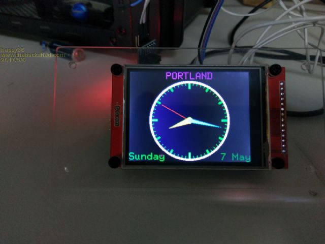

Thanks ,turns out the file I was send was corupt,I re download all good
Heppy
