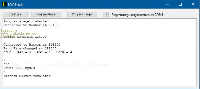

A year or so ago, I wrote a Windows GUI wrapper for pic32prog to make it easier to program micromites using an Arduino or micromite.

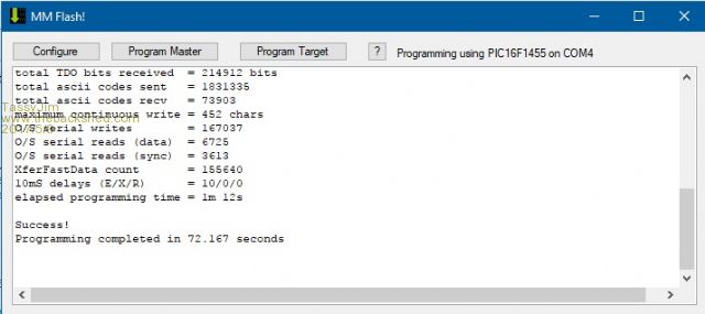

Now that we have the Microbridge, I have updated my program to add the Microbridge to the list of supported devices.
I have often used the Arduino method and found it quicker than using the PICkit3.
Now I have a MMX board with the Microbridge built in, I find programming the MMX a breeze.

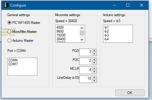

MMFlash doesn't let you do anything more than you can using pic32prog.exe directly, but I like to think it's a bit easier.
All the hard work has been done by Robert Rozee and Peter Mather. I did the easy bit.
The only thing to configure for the Microbridge is the COM port
Programming the MMX takes about 72 seconds.
