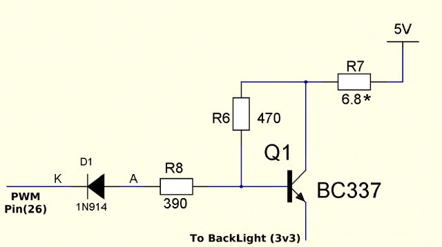

There was an extensive discussion on this 12-18 months ago.
It really is not easy to drive a 3v3 powered LED circuit fully using a 3v3 high level drive)
The circuit below is what I use for my BackPack 170 and does work very well.. The resistor values are pretty tight so you may not get a good result by changing them but it has always worked well using the values shown. I tried a BC558 transistor but could not get full brightness).
You can use PWM to set any value brightness between OFF and ON or simply any 3v3 output pin so that LOW=OFF and HI=ON.

Graeme,
The secret to the above circuit is the blocking diode, this allows the transistor bias resistors to pull the base of the BC337 to around 3v8 or slightly higher to turn the transistor on without causing damage to the 3v3 level PIC pin.. The backlight will draw about 60-70mA at around 3v3 when on.
In any case it just works.. All my backlight boards now use this circuit..
