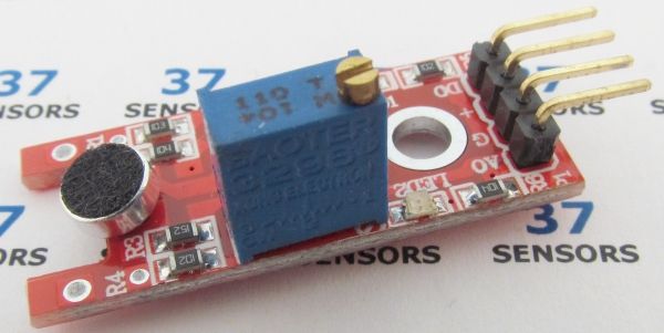

If it is one of these sensors:
There is a digital output on the sensor. This is a threshold output that is adjustable by the potentiometer on that board. That would be usable as an input to the Micromite.

Mine doesn't have the adjustable pot.
