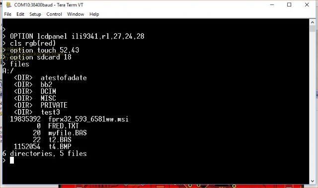

Please download the new release from here
This is a major change to the software that completely swaps the file system handling in order to support long filenames. The original file system routines were provided by Microchip but in the latest release of their demo apps they have moved to Chan's open source routines so it looks like they won't be supporting their code going forward.
Chan's code has established itself as the default for FAT file handling and Geoff is also likely to move to this in a future release.
Not only is the new code future-proof and properly open-source but it is also much faster that the original code. The H/W interface routines are not part of FatFs but are provided by the developer to suit the platform. I've developed and tuned these routines as part of the MMX code such that the time taken to save a 640x480 image to disk has reduced from 8.5 seconds under the Microchip code to 0.62 seconds now.
As this is a major change, bugs are to be expected so please report findings so I can find and fix them
