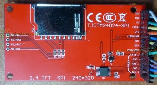

  Quote  IF you can get to the 4 touch wires (the ones going from the display to the touch controller) you can use a touch to switch a transistor.
These connections seem to be at the back of the display between the PCB and the display but they may be accessible at the vias to the left of the touch chip XPT2046 on pins 3,4 and 5.

The touch wires don't look easy to get at with the 2.4 panels.
BUT:
Geoff has given you a late Christmas present with the beta10 firmware.
  Quote  Implemented the GUI RESET LCDPANEL command. This will reinitialise the LCD panel
and is useful if the panel had been previously powered down to conserve power.
This 'should' mean that you can power the LCD controller chip down and recover OK when you wake up.
To use the touch to wake up, you will have to disconnect it's power pin from the LCD panel regulator and supply it separately.
The regulator is above the XPT2046 in your photo and (if I am correct), you need to cut the trace under the 'C1' text.
Either that or cut the trace where it goes to the main controller (after C1) and supply the controller with a new regulator.
I don't have a circuit diagram and haven't looked at the other side of the circuit board so there is some guesswork here.

Joined: 08/08/2017
Location: Mexico
Posts: 26
Posted: 06:26pm 25 Sep 2017
