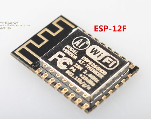

I like to use the ESP12F which has (supposedly) a 'new and improved' design, and also a 'better range'. I cannot confirm this myself as I only use within the confines of a small home, however, the fact that the 12F exists, is the reason I use them.
I do not go for any of the 'lower numbered' modules as none seem to offer the shielding and regulations that the ESP12 offer.
There are higher number units I have seen, but I have never had an issue with the 12F.

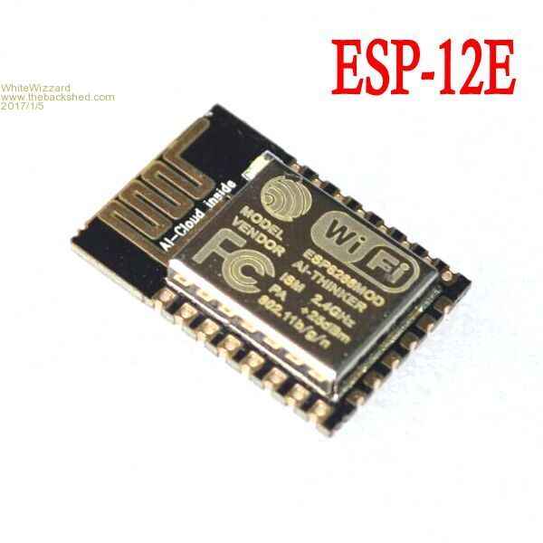

By the way, the 12E and 12F are externally labelled the same on the units I have seen, however, their antenna 'etchings' are different to each other as shown below
WW

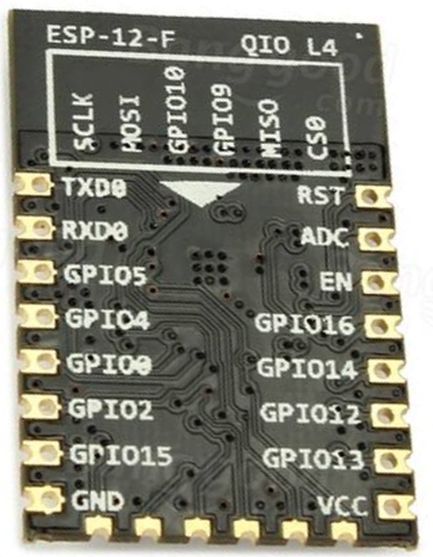

The ESP-12F modules that are sold by Banggood are identified on the rear as 12F
http://www.banggood.com/ESP8266-ESP-12F-Remote-Serial-Port-WIFI-Transceiver-Wireless-Module-p-1007260.html
