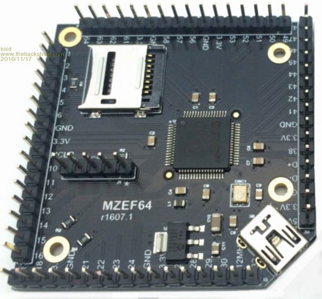

Here is the final schematic based on the update pinout which equalises Peter's MZ port with mine so now we have a single pinout which is to the largest possible extent pin-compatible with Geoff's original MX470 version.
2016-11-17_172127_MZEF64.pdf
I have these in manufacturing now. Since I have been asked, currently have a few MZEF64 boards from the first revision (in the picture below) which are the same but without the MikroBus connectors. If anyone wants one, let me know. The new ones will be available by mid December.

Looks lovely!
Posts: 2994
Posted: 09:11am 17 Nov 2016
I agree with JohnS; this truly is a Work Of Art
Posts: 10075
Posted: 10:41pm 17 Nov 2016
I think I may have said this before, but I am really impressed with your extremely crafty placement of the USB socket - nice thinking, dude!

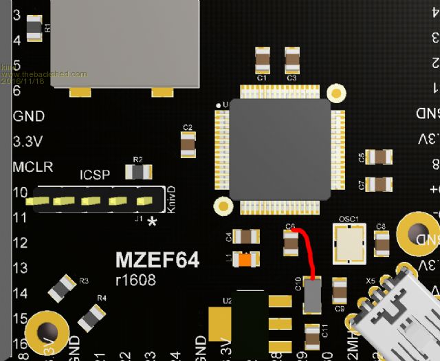

The assembled boards are all gone now. I discovered that I have a few blank PCBs from the first batch, £1 a piece. If someone wants one, leave me a message.
These blank PCBs are the older revision and require a small wire patch as shown in the picture. Please everyone who has one note this.

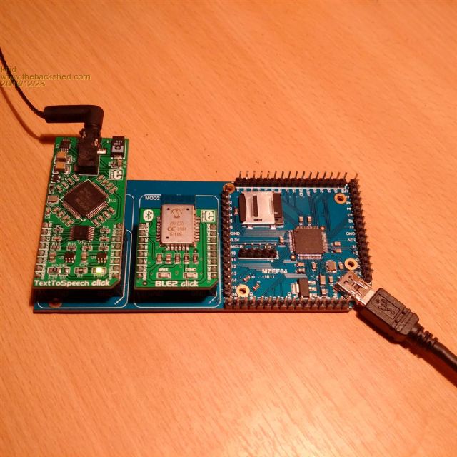

Posted: 07:18am 28 Dec 2016
Enjoying my new MZEF64 board equipped with 252MHz chip
5213 result on the grain test is not a joke...

How 'good' is the Text-to-Speech Click? Also, what chip is it using?
Thanks for any info . . . .
WW
kiiid
Joined: 11/05/2013
Posts: 671
Posted: 07:44am 28 Dec 2016
John,
I will have that information soon. Availability - from me, I guess (unless someone else wants to distribute as well).
WW,
Just starting with the TTS so no idea yet. It uses Epson's S1V30120 engine.
