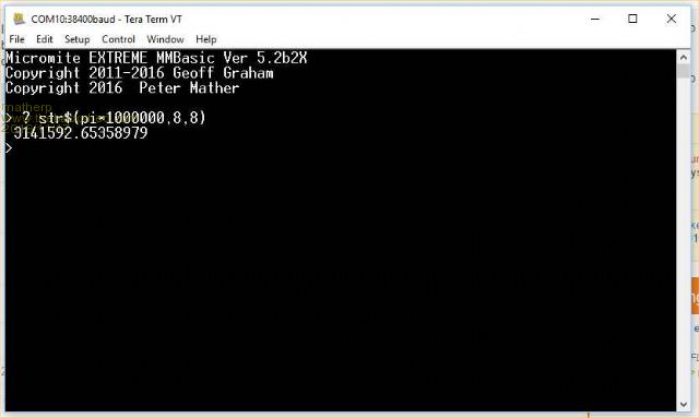

Geoff's underlying code in MMBasic is just extraordinary. I've just been able to convert all floating point arithmetic from single to double precision floating point (the PIC32MZ processor supports double precision in hardware) in less than 2 hours and half of that was finding all the instances of things like sinf() and changing them to the double precision version
This really does open up a whole new set of applications where accurate trigonometry is essential and because the calculations are done in hardware they will still be much faster than the single precision calcs on the MX470
The new beta also changes a number of pin allocations to better match both the MX470 and ELLO
