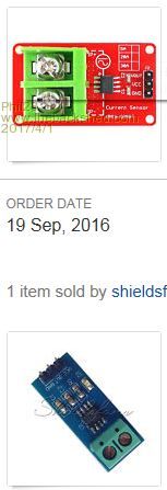

I use the ACS712 for low currents 5, 20 and 30 A bidirectional
and the ACS758 for 50A and above
They have a +/-100A and 100A unidirectional, one of which would be ideal for your 80A
The advantage over op-amps is they are isolated and can be put in either the positive or negative rail.

I agree with Jim, the ACS758 would be ideal for you. You can buy them as individual chips or as a module - the latter available on ebay for around $15. I have used a number of these with a Maximite and they work a treat. Just a resistor divider to bring the 0 to 5V output of the ACS758 down to a voltage that the Maximite can handle and possibly a capacitor to stabilise any noise.

The ASC712 units output 2.5V with zero amps flowing.
If you install them the right way around, the output will go lower with increased current.
I am using 30A ones on my solar monitor. With 11 amps flowing the 'wrong' way, the output reaches 3.3V
One sensor I have can go that way when an AC charger is running but it's output is less than 11A so I have no problems.
Under normal current flow 30A would have the output at about 0.5V so there is no need for any voltage conversion.
I had 'fun' getting reliable zero current readings. I will post a description of my efforts 'soon'

Like Jim, I had trouble getting the zero current reading correct and reliable. My approach ended up using ACS758 modules with the bi-directional version.
As I only needed to monitor current to 50A, I used the +/- amp version. Each module has an LM317 variable voltage regulator on it and I modified the output adjust resistor divider chain by adding a 250 ohm 25 turn trimpot into the chain such that I could adjust the supply to the ACS758 from 4.9volts to 5.1 volts. This in turn allowed me to "tune"the zero current point to exactly 2.5 volts. I have 5 ACS modules set up this way to read a range of charging and load currents in the van.
In the umite, I read the output of the ACS758 directly with 2.5 volts equal to 0 amps and 0 volts equal to 50 amps. So, input pin minus 2.5 times 20 gives a direct current reading.
There is a bit of loss of linearity as the ACS758 output gets close to 0 volts (50 amps) but as I only need to work from around 0 amps to a max of 30 or so, it is not a problem for me. The supply to the mite needs to be exactly 3.3 volts with as little system noise as possible (as you would expect).
For voltage measurement, I use the standard resistor divide chain but add in the 25 turn trimpot to "tune" the values as needed.
Checking with a good quality meter, both voltage and current readings are good to about 1%, more than sufficient for my requirements.
