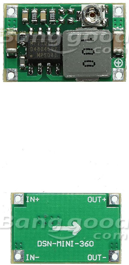

I have bought some of these to play with, but I am suitably impressed with the price-point vs regulator ability and current output.
Impressive $1 regulator modules.
They appear to use the MP2307 buck-regulator IC, and this regulator chip is capable of up to 3A output. These modules cannot do that kind of current, but even if you can get, say, 500mA out of it for the price.......
And all the associated caps and resistors done for you - plug and play.
The MP2307 can use a Vin of 4.75v to 23v, and a Vout of 0.9v to 20v
Quiescent current of this one is 1.3mA typical, so not as good as some LDO regulators at about 200uA or so, but still four times better then the 5mA or so of the 1117 regulator and seven or eight times better then the LM78xx series.
Me like these ones, as they will make ideal on-board regulator modules for lots of stuff, and being so cheap, they work out cheaper then just my current weapon of choice regulator IC alone, and that is for an assembled module!
I expect they mass-produce this one in the hundreds of thousands of units(if not millions), so that is why the price is so cheap.

Hi Grogster:
What makes you think it can't run at 3 amps?
The spec sheet says it can.
MPS2307
It is a switching regulator.
redrok
Posts: 10074
Posted: 01:56am 29 Sep 2016
Only lack of heatsinking in this particular tiny package. Realistically, you could expect an amp or so no problems, but pushing it to 3A might prove to be a problem becasue of lack of room for any heatsinking.
However, the 2307 does have an exposed bottom thermal pad, and this looks like it is soldered and coupled to the bottom ground-plane to use as a heatsink, so you might be able to get upwards of 2A out of it as-is.

Hi Grogster;
First order power dissipation calculation:
In this type of switcher the current flow is constant and time divided between
the high and low side MOSFETs. So assuming 3A and a body resistance of 100mO:
I^2 * R = W
3^2 * .1 = .9W ( neglecting switching losses and other resistances)
The spec sheet asks for a 1"^2 PC Board for reliability.
This board is:
.67" * .43" = .29"^2
.29"^2 / 1"^2 * .9W = .26W derated power
(.26W / .1)^.5 = 1.61A derated current for the small board.
It would seem that this PC board could be silicone glued to an aluminum plate
with Kapton tape sandwiched in there and get full current capabilities.
It also might be good to add the Schottky diode D1 as suggested in the spec to
improve efficiency. It looks easy to do.
BTW, I would hope the inductor is up to par with 3A.
redrok
Posts: 10074
Posted: 04:06am 29 Sep 2016
Awesome - thanks for the maths, that really helps explain the derating well. I was about 400mA off with my guess of about 2A allowing for the bottom copper as a small heatsink.

Posts: 2982
Posted: 04:29pm 30 Sep 2016
Hi Grogs, All,
Even cheaper.. $1AU ~ $0.76US
And then there are these (about 5mm wider and higher -- 0.2") but seem to have the diode mentioned by redrok.
DC-DC

Posts: 12061
Posted: 09:37pm 30 Sep 2016
The problem with all these modules is that they advertise "variable" output voltages but when you look at the datasheets you will see the inductor and other support components should be optimised for a specific output voltage. I've got some of the second boards listed by Mick and my ones have a 4.7uH inductor. Looking at the datasheet for the MP1584 controller chip used this is specified for 1.8-2.5 volts output!
Using the boards outside this range will decrease efficiency, increase output ripple, and reduce power capability.
The datasheet for the LM2596 explains this very well, see the charts on page 19. This datasheet also explains the best types of inductor to reduce EMI
I'm just about to layout a board using the LM2596 and because I know the input voltage will be 12V and I need a 5V output and I know the maximum output I need will be 1A, I can pick an optimum inductor and get best efficiency.
