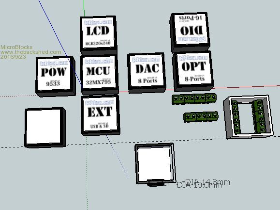

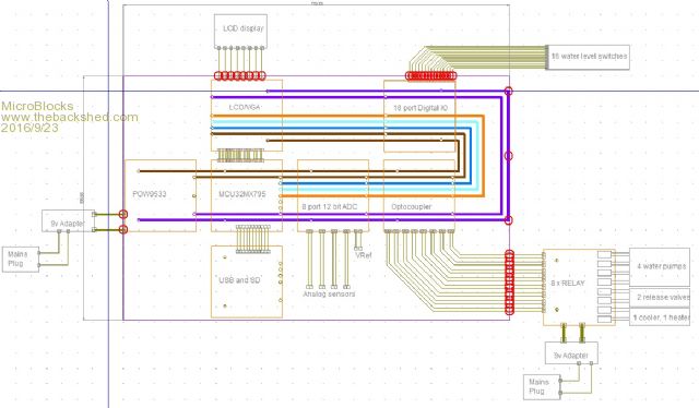

Posted: 09:10pm 22 Sep 2016
Holy sh.....
That is what i am working on with my 'Microblocks' but more sophisticated.
The housing is the part i struggle with the most because in low/medium quantities they are expensive because the molds. So expensive it makes the rest irrelevant. I am now concentrating to use aluminum profile with laser cut caps and 'rings', which might be a solution.
