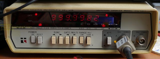

The picture is of my counter/timer set up with a 10-second gate time measuring a 1MHz output from the Micromite

I don't quite get it
do you have to have a frequency counter connected while this is running?
or do you have to measure the clocktrim at given temperatures then run the program?
my clocktrim is 4 at 23°C would I have to measure this a 22 and 24 deg to get it to work?
I don't "quite" get what this needs
