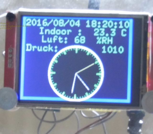

first many thanks to
P.Mather (BMP180)
G.Graham(Clockface)
and
Duane C. Johnson AD0TJ
i have take there codes shake it 3 times and so you can see the result
needed parts
a LCD Backpack from SiliconChip
a RTC
a BMP180
and a HIH 3030
cpu 48

Hi RonnS,
it's a very nice clock!
Can you tell me what a HIH 3030 is? Is it a humidity sensor? Where is it to buy?
Thanks!

.. hello, an thank you
yes it is a Humidity Sensor with a simple analog output
link
RonEdited by RonnS 2016-08-06
