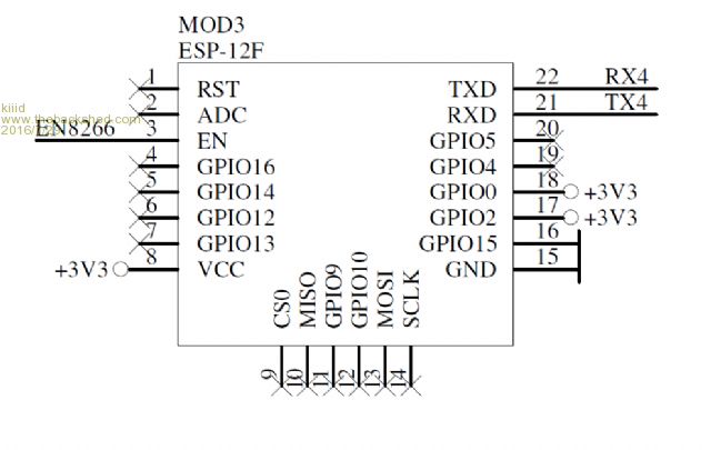

This is my first touch with this thing, and so far it has been a pretty frustrating one.
It simply doesn't respond to anything. I have it connected the simplest possible way as in the picture (the power supply is proper, but not displayed).
So when I bring the EN8266 high, I expect the module to start responding to AT commands, is that right? Well, it doesn't. There is a small LED which I have no idea what is for, on board next to the antenna, but it doesn't turn on either.
My protocol is 115200,8N1. I verified the communication and I am sure the module gets what I am sending, but nothing comes out of it in response.
I tried with another two modules, and got the same lack of success.
Any advices from people with more advanced experience in this thing?
Thanks!

Instructions here
VCC ----> 3.3V Power supply (
GND ----> Ground of power supply
CH_PD ----> HIGH (3.3V)
GPIO2 ----> HIGH (3.3V)
GPIO15 ----> LOW (GND)
GPIO0 ----> HIGH or Floating for AT Mode (3.3V) [ * if you want to flash completely different firmware then you must connect it to ground ]

I use an ESP8266-01 and it drove me nuts at first, then eventually I figured it out and was able to flash different firmware
Now I have it flashed with ESP8266 Basic and after a learning curve, I got it working
They aren't the easiest devices to work with, but they are amazing what they can do

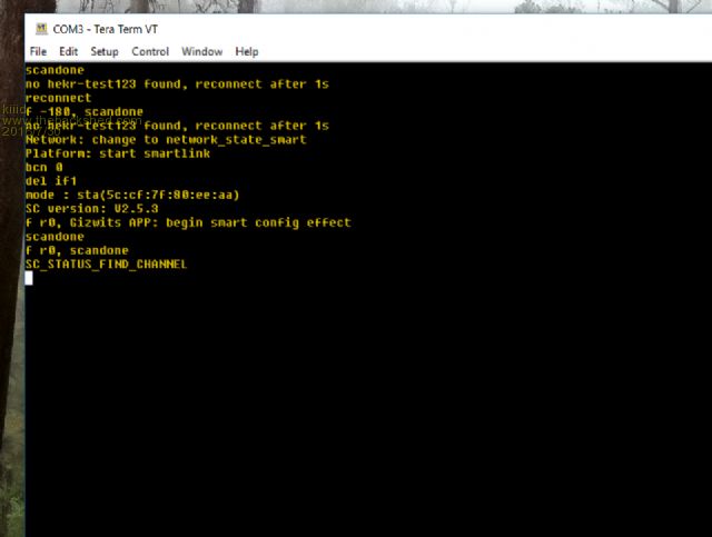

My problem is that the module doesn't give any sign of life. I tried already with AT
Bought for testing a development board like this one but can't get it working as well.
When I connect it to the terminal, it prints some stuff as in the picture, and then ends with that message SC_.... and I can't do anything else anymore.
The modules which I have purchased separately don't even show that much. In fact they show nothing.
To me it looks like there are different types of firmware for this and I've got the wrong one?

Posted: 02:32am 30 Jul 2016
You have one of these:
https://gregwareblog.wordpress.com/2016/01/10/esp-witty/
Best to flash it with the firmware you want.

  MicroBlocks said   You have one of these:
From that page
Built-in I/O wiring:
As found out by sej7278 in THIS post, the wiring is as follows:
Push Button on GPIO04
Red LED on GPIO15
Green LED on GPIO12
Blue LED on GPIO13
Photo Resistor on ADC/TOUT/A0 pin
Firmware setup and Control UI:
The board boots with its UART set at 115200 bps, and spits out a ESP SmartConfig sequence, similar as:
mode : sta(5c:cf:7f:11:97:80) + softAP(5e:cf:7f:11:97:80)
add if0
add if1
dhcp server start:(ip:192.168.4.1,mask:255.255.255.0,gw:192.16)bcn 100
SDK version:bcn 0
del if1
SC version: V2.5.0
f 0, scandone
f 0, scandone
SC_STATUS_FIND_CHANNEL
If the button is pressed, a message button_press_3s! is output too.
kiiid
Joined: 11/05/2013
Posts: 671
Posted: 04:04am 30 Jul 2016
Ah...
So where do I get that firmware which is only working with the simple AT commands, and how to flash it?
http://rittle.org
lew247
Joined: 23/12/2015
Posts: 1709
Posted: 04:52am 30 Jul 2016
  kiiid said   Ah...
Google ... Here
or if you don't like that page
try this one Edited by lew247 2016-07-31
Posted: 05:56am 30 Jul 2016
or visit:
Everything ESP8266 Edited by MicroBlocks 2016-07-31

Posts: 711
Posted: 10:47am 30 Jul 2016
  kiiid said   Ah...
Here you go includes a screenshot of the flash programs setup (ESP_DOWNLOAD_TOOL_V2.4.exe)
