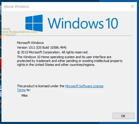

Installed on following system (64 bit machine.....No probs up till now)-

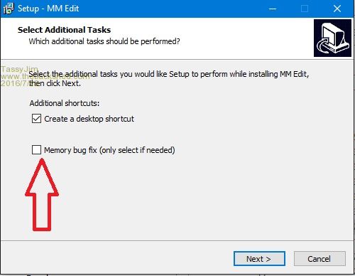

You could try reinstalling again but this time select the Memory Bug Fix option.
There is no need to uninstall.
This will leave you with the old TKN file which doesn't like the new larger syntax files.
You will then have to replace the TKN file with the one I posted here on 9th July.
A quicker alternative is to replace the two files (in the program folder) with the ones in this ZIP.
http://www.c-com.com.au/stuff/XPfix.zip
This method changes the bug fix EXE and also updates the TKN file to the latest beta which is happy with the V5.2 syntax.

Uninstalled and re installed with the 'bug fix' option.
Seems to be all good now. Thanks very much.
