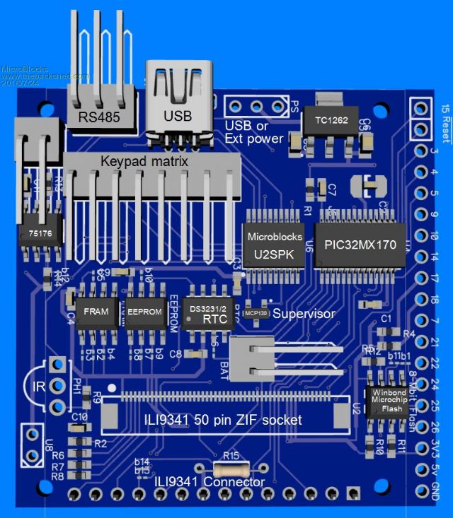

(Still have to find a good name that describes this design of this future product.)
It is based on the LCD backpack from Geoff but with added functionality.
Usage is mainly as a little control box that has all the main features on board.
Most pins are available on the 19 pin header for connecting to other modules/parts.
Extra on board features are:
* Zif socket for direct connection of ILI9341 LCD
* 14-pin header for standard ILI9341 LCD carrier boards
* Onboard USB-Serial converter (U2SPK chip)
* PIC32 Programmer (U2SPK chip)
* Keypad or switches 4x4 matrix scanner (U2SPK chip) (in development)
* DS3231/2 Real time clock with battery connector
* FRAM
* EEPROM
* Winbond or Microchip Flash
* IR receiver
* RS485 Half Duplex Transceiver
* Compact size of 50x50mm.
Schematics:
2016-07-24_233736_DipTrace_Schematic_-_LCD24-170.pdf
The keypad matrix scanner injects ASCII code into the serial buffer so keys can be read with standard INPUT or INKEY$ commands. It allows between 1-16 switches or keypads which are also debounced, without the need of any programming in the micromite.
3D top view:
I would appreciate some extras eyes going over the schematics, especially the RS485 and ILI9341 connectors.
Edited by MicroBlocks 2016-07-25

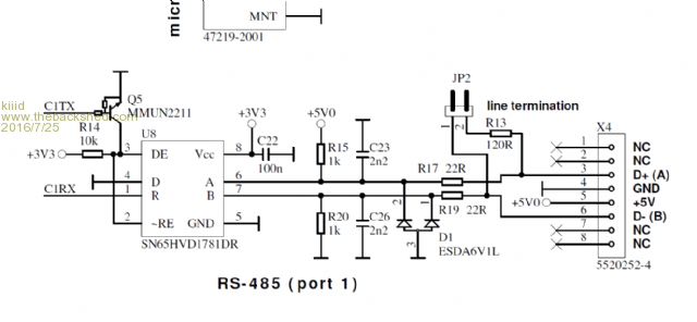

Ok, here is a little trick here, which I have been using for years and will share now.
You don't need an extra control pin for the RS-485 interface, and can use it with a normal UART (or COM port in MM).
It requires a bit more untraditional connection of the transceiver, but only one external transistor is everything necessary. You can ignore the part on the RS-485 side, it is my schematic, but yours can be different. Note the left side in the schematic where is the actual difference.
Again, this has been tested in a number of designs over years and it 100% confirmed functional. I have tested it with MM as well.
http://rittle.org

Posted: 12:09pm 25 Jul 2016
@geoff
Thanks Geoff. Inverter it is.
@kiid
I've used RS485 transceivers for years and have never dreamed of connecting one this way. Never had to I guess. Well done for ingenuity.
Posted: 06:53pm 25 Jul 2016
Thanks Kiiid, that is a neat trick!
I am reconsidering including RS485 on the board itself as in most cases it would be better to have an isolated transceiver. I am thinking about using this little control board as a slave or master as part of a network that has sensors, valves and other fun stuff over undetermined distances in and out of the house.
And with this trick i can use either com port leaving the DE pin available.

@Kiiid,
Which of the mmun2211 should i use?
There are a whole bunch of different ones with specific resistor values.
Some of them have resistors that are equal and some have a 1:10 ratio.
I am also not able to source them locally.
Would this (KRC102-AT/P with 10k resistors) be a good substitute? Unfortunately minimum order is 100 so getting one that is equivalent would be nice. :)

kiiid
Joined: 11/05/2013
Posts: 671
Posted: 07:14am 26 Jul 2016
You don't need to use that particular type. I only use because I like the biasing resistors inside, but their values are not critical. I guess most models will work fine. You can also replace it with any n-channel mosfet.

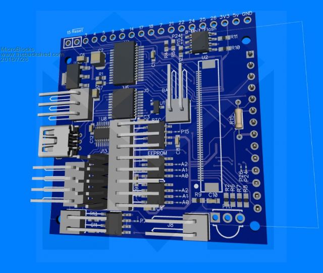

Made some changes. Added a 4017 chip to allow for a 10x8 matrix. This allows for 1-80 switches to be scanned which should be enough for a small full keyboard.
Schematic(red areas still to be done/checked):
2016-07-26_220926_DipTrace_Schematic_-_LCD24-170.pdf
3D (LCD display will be on the other side, this has all the headers to see if it all fits. Most headers can be straight or 90 degree to allow for lower profile.
I will have to wait for some parts to do the final measurements.
