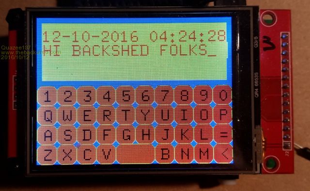

A tiny keyboard test using = as RET, < as BS and touching the text area as clr.
Print "LCD Backpack 3"
Print "tiny keyboard.bas"
Option base 1
RTC gettime
SetPin 15, intl,touched
Dim rcolor(2) = (RGB(red),RGB(yellow))
Colour RGB(blue), RGB(blue)
Dim my$=""
CLS
Font 1, 2
Box 0, 0, MM.HRes-1, MM.VRes/2-10, 8, , RGB(yellow)
initkb
If kp Then
Select Case k$
Case "="
Print my$
Text 9,MM.VRes/6," ",,1,2,RGB(red),RGB(yellow)
my$=""
Case "<"
'Print "you pressed BS"
If Len(my$)<>0 Then my$=Left$(my$,Len(my$)-1)
Case Chr$(12)
'Print "clear LCD text area"
my$=""
Case Else
If Len(my$)<17 Then my$=my$+k$
End Select
Text 9,MM.VRes/6,my$+"_ ",,1,2,RGB(red),RGB(yellow)
kp=0
End If
' This is where the main work is to be done.
Text MM.HRes/2,30,Date$+" "+Time$,cm,1,2,RGB(red),RGB(yellow)
Loop
Sub touched
tx=Touch(x):ty=Touch(y)-yos
itx=(tx\32)+1:ity=(ty\32)-2
If (tx<1) Or (ty<1) Then Exit Sub
' touch text area to clear
k$=Chr$(12)
kp=1
PWM 2,1200,55:Pause 50:PWM 2,STOP 'Beep
If Not (ty =>100) Then Exit Sub
Text 10+(itx-1)*32,4+(ity+2)*32+yos,key$(itx,ity),,,,RGB(black),RGB(white)
Do While Touch(x) <> -1: Loop
Text 10+(itx-1)*32,4+(ity+2)*32+yos,key$(itx,ity),,,,RGB(black),RGB(brown)
k$=key(itx,ity)
End Sub
Sub initkb
Dim string key(10,4)= ("1","2","3","4","5","6","7","8","9","0","Q","W","E","R","T","Y","U","I","O","P","A","S","D","F","G","H","J","K","L","=" ,"Z","X","C","V"," "," ","B","N","M","<") length 1
yos=15
For y=1 To 4
For x=1 To 10
RBox (x-1)*32,(y+2)*32+yos, 32, 32,,RGB(yellow),RGB(brown)
'a quick patch for the space bar
If key(x,y)=" " Then RBox (4)*32,(6)*32+yos, 64, 32,,RGB(yellow),RGB(brown)
Text 10+(x-1)*32,4+(y+2)*32+yos,key(x,y),,,,RGB(black),RGB(brown)
Next x
Next y
End Sub
