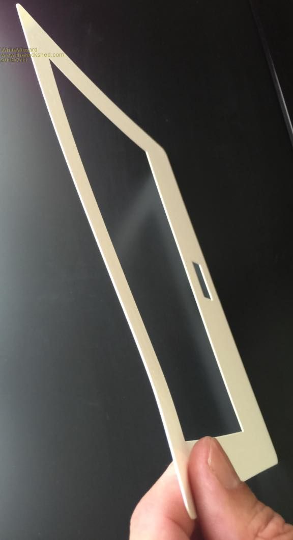

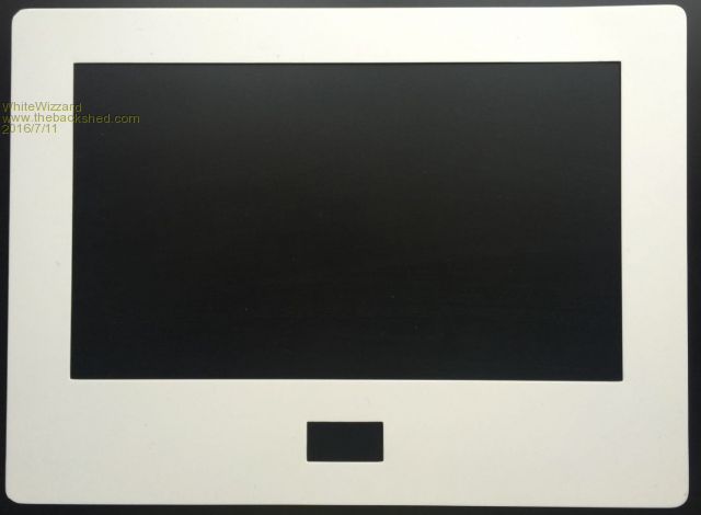

One approach I have used with a very neat finish is thin plastic sheeting cut with a computer controlled vinyl cutter.
Search for 0.5mm HIPS - you can pick up an A4 sheet for not much money at all (and in various colours).
I used a Silhouette Portrait Vinyl Cutter with the HIPS after designing my front panels in Corel Draw. The cutter will cut through much of the thickness, and only slight 'man-handling' is required to get a clean break.
This method allows for the many different TFT sizes that are available (as Peter highlighted).
By the way, the laser cutter approach only resulted in vertical cuts in perspex. It was ok, but I think I would always prefer the 'bevelled' CNC approach (again using HIPS, but with a 2mm - 3mm thickness).

Posts: 2994
Posted: 11:27pm 10 Jul 2016
A picture paints a 1000 words; so here's 2000 words
Note that this is 0.5mm HIPS so is flexible (which is why the bottom picture looks like the panel is 'bendy')
