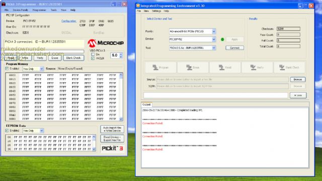

Hi All.
I recently purchased some PIC 32MX170F256B's but for some reason I am unable to connect to them.
I have been program various PIC's for a number of years using a genuine PICkit3 and have not had any problems. I originally used the PICkit3 apllication V3.10.00 from Microchip, but when I tried programming the PIC32's today I couldn't get anything working even though I could connect to a PIC18F452 a PIC18F25K22 and also a couple of 16F devices with no problems.
Also I have the PIC 32's on a breadboard and the Micromite MK2 backpack but still cannot connect.
I then went to the forum and did a search and found mention of the MPLAB IPE. I downloaded and installed both the IDE and the IPE but could not connect to anything!!!
I have tried various ways of connecting. i.e. Using my USB hub and also plugging straight into a PC USB. With external power applied and not applied. Also using a PC running XP and my new one running WIN 10.
Please see the 2 IPE's in this picture.
I hope someone out there has some ideas.
Mike

Based on what you have said, and keeping in mind you have already tried things like power applied and not applied, and having the PK3 connected directly to the PC, I am inclined to think that either your USB lead is crook, or your PK3 is crook.
The fact you have also tried W10 and XP means it can't be an OS problem either.
Your image is too fuzzy to be able to read any of the text. If you re-post the image as a GIF rather then a JPG, it will show up much sharper.
Do you happen to have another PK3 to try?
I could send you one of Rob's ASCII ICSP units if you wanted to assemble that - this is now my preferred method of programming PIC32's these days cos it is small, simple, and works without having to deal with MPLAB's convoluted 100MB or so install package just to program some chips.(if you need MPLAB to develop C code, that is another matter)Edited by Grogster 2016-05-22

  matherp said
  Quote  However as you already have a pickit3 i would first try to place a capacitor on the VCap pin as that solved most programming problems for me.
Like he said
Without a Vcap capacitor the chip is not programmable
I Did manage to flash one without VCap when I didn't realise it was required.
Powering from the Pickit3 wouldn't work, but external power did.
Maybe a fluke, & not recommended though.
