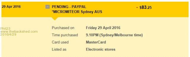

Interesting observation after ordering an Explorer 64 from micromite.org.
It was pretty obvious the site is UK based, from the currency down to all the contact detail.
What surprised me was the way the PayPal transaction appeared on my MasterCard.
Does this indicate that there is a local point of distribution here in Australia?
Cheers.
Bill7300
Joined: 05/08/2014
Posts: 161
Posted: 02:17pm 29 Apr 2016
Probably just indicates the time the Bank's system processed the transaction, expressed in local time and place of transaction.
