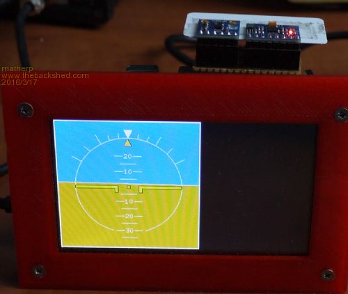

When I started this I really wasn't sure whether it would be possible to make it work but it does.
Please see the video here for proof
The hardware is a 64-pin MX470 running the Micromite+ firmware V5.1. The screen is my favourite 4.3" SSD1963 display. The gyro/accelerometer is a MPU6050 and the magnetometer an HMC5883 giving 9-DOF (degrees of freedom) input. It should run on a 44-pin Micromite as well but will give a slower screen refresh rate (currently 12fps) and the Cfunctions will need putting into the library to save space.
The software comprises 4 main modules:
Sensor initialisation and reading
Sensor fusion using my port of Kris Winer's version of the Madgwick/Mahoney routines
SSD1963 driver supporting overlay text and paging
display drawing algorithms
The various other threads I've created recently show the evolution of the various modules and the code in this thread brings it all together.
Along the way I've had to learn a bunch of new stuff: algorithms for bounding an arbitrary line (the horizon) in a box; quaternions and their use in 3D graphics; creating a rolling average of angles (seems easy but what happens when you go from 359deg to 1deg?); the use, limitations, and calibration of accelerometers, gyros, and magnetometers; etc.
Anyway the code is now finalised in a working version and just needs tuning in a real aircraft with real rates of angular change. I also need to work out what to do with the rest of the screen real-estate.
Hopefully you can find bits of code in here that may be of use to you but if nothing else it has to be a good demonstration of what you can now do with a Micromite - try doing all this on an Arduino

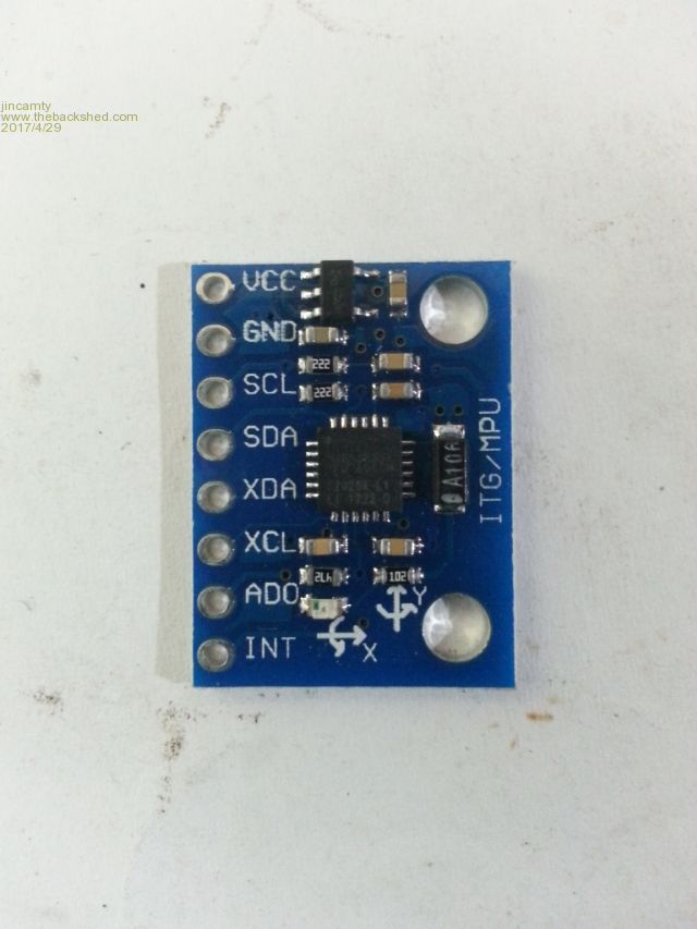

' Micromite AHRS using MPU6050
' Original source ode from kriswiner (https://github.com/kriswiner/MPU-6050)
' and Sebastion Madgwick's Open source IMU and AHRS algorithms
' Use TFT display in landscape mode to display position
' MPU6050 connections
' GND
' VCC - 3.3V
' SCL to I2C clock
' SDA to I2C data
' NCS to 3.3V (needed to force I2C)
' INT to intPin
' AD0 to GND or 3.3V (see address below)

Posts: 2994
Posted: 07:18am 17 Mar 2016
  matherp said  . . . Anyway the code is now finalised in a working version and just needs tuning in a real aircraft with real rates of angular change
. . . . and it just so happens that I know you have an aircraft in your front garden Any plans on finishing it this summer so you can test this 'module'?
Once again - an outstanding piece of work (and in such a short timescale)
@Geoffg - Did you ever expect to see something like this based on your creation(s)?
@ALL - Anyone want to guess what matherp's next 'marvel' will be (or request one )

Posted: 01:52pm 17 Mar 2016
Pretty impressive. I suspect that vibrations from the engine in an actual aircraft may be an issue so you be investigating physical mountings/software dampening to smooth them out from the display.
Neat bit of work.
Posts: 2552
Posted: 05:24pm 17 Mar 2016
an impressive result!
have you any plans to incorporate a compass display and altimeter into the code too? this would give you all three major instruments on a single (wide) LCD panel.
in small aircraft, are electronic gyroscopes a common solution? in certain odd flight patterns (a parabolic curve?) i recall that they can give results that differ from a mechanical gyroscope.
again, great work. this could certainly make a great SC article, perhaps titled "glass instrument panel for the keen hang glider".
rob :-)

Posted: 07:47pm 17 Mar 2016
Since this instrument is using an accelerometer will acceleration, deceleration and centrifugal force affect the reading.
Paul.
Posts: 12071
Posted: 10:45pm 17 Mar 2016
  Quote  in small aircraft, are electronic gyroscopes a common solution?
Yes - lots now in use
  Quote   I suspect that vibrations from the engine in an actual aircraft may be an issue
  Quote  Since this instrument is using an accelerometer will acceleration, deceleration and centrifugal force affect the reading
  Quote   i recall that they can give results that differ from a mechanical gyroscope.
The electronic system uses 9 sensors which act together to compensate for all of the above.
Conventional gyros exhibit a number of errors.
Acceleration error - with an air driven gyro the instrument will show an erroneous indication of a climbing right turn as the aircraft accelerates stright and level.
Turning errors - caused by the differential centrifugal force on the erection chamber and vs the vanes which act to manage the airflow to erect the gyro
In the electronic version, the gyros are "rate" gyros so only give the rate of change of movement. The sensor fusion takes all the inputs and creates a composite output. So specific error conditions on say "x-axis acceration" will be mitigated by the stability of magnetometer and gyro-rate readings
  Quote  have you any plans to incorporate a compass display and altimeter into the code too?
yes but I need to be careful of additional processing overhead. I'm getting 12fps at the moment and don't want this to drop too much. Rates of change in aircraft (other than advanced aerobatic) are not that great so 12fps should give a stable but immediate response. Going down to say 5fps could be an issue
Posts: 10075
Posted: 10:46pm 17 Mar 2016
Ahhhhh - I was joking about you having it done by Friday, matherp!
Crikey - nice work.

Posted: 12:46am 18 Mar 2016
I found a 4.3" Display that I ordered a while back. So I will be building up one of these awesome units to play with..! Will any of the 4.3" Displays have the extra memory inside the graphics controller for the 3 pages needed..? I think the transparency on text is a very needed feature also. Can this function be applied to other types of objects also..?
Awesome work Peter..!! If the Micromite can handle doing this, then all the rest of the instruments in the cockpit will not be a problem to complete... I am very impressed with this... Can't wait to get this going...
Posts: 12071
Posted: 01:27am 18 Mar 2016
  Quote  Will any of the 4.3" Displays have the extra memory inside the graphics controller for the 3 pages needed
As long as they use the SSD1963 controller - yes. Note the paging only works in landscape mode. I need to update the driver to block attempts to use it in other modes as the display mapping just goes crazy
  Quote  Can this function be applied to other types of objects also..?
It works with GUI bitmap and text. All the other drawing commands just write an outline or a filled outline so the facility doesn't apply.
Edited by matherp 2016-03-19

Joined: 10/07/2011
Posts: 21
Posted: 10:53pm 28 Apr 2017
MPU-6050 GY-521 breakout board
Thanks Jim.
Can you or someone please send me a link on how to connect this to a CGCOLORMAX2
or explain what pins to use?
Also what firmware version do I need for this?
All I can find is Arduino related articles.
I would like to wire this into the board and sort the code out later when my head is clearer.
Cheers Cam
