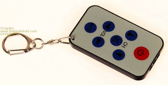

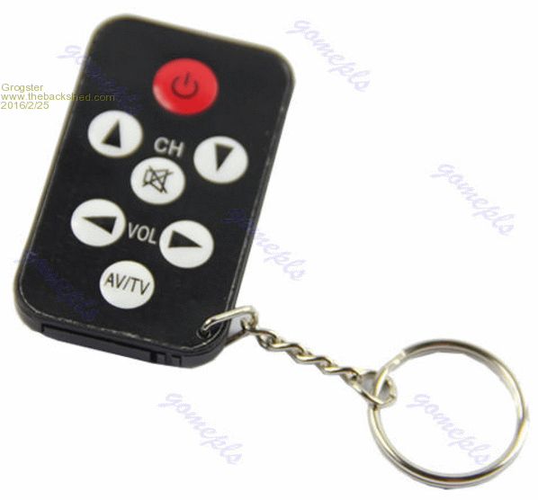

Hi all.
This thread might be of interest to some, but probably CG(CircuitGizmos), as I know he has some of these remotes.
After a bit of tinkering around, I have these remotes working well with the MM.
They are extremely cheap, averaging US$1 on eBay..
They are a universal remote designed for TV use, and thus, they can output many different codes. In my case, I found a device code and keycode combination that seems to work well, and then wrote a very simple code to allow you to search for the correct settings in the remote, without having a TV set to experiment on.
The code will prompt you of what to do, and all you have to do, is follow your nose.
I have run the code several times, and the keycodes always come out the same, so I think I have it such that the codes will be consistantly correct from this remote, but this code should be treated as alpha, and the idea as experimental.
I have tried this with both 38kHz and 40kHz IR receivers, and both work fine.
The 40kHz receiver gives best range, so I think we have hopped onto a Sony frequency - that or this is just good luck.

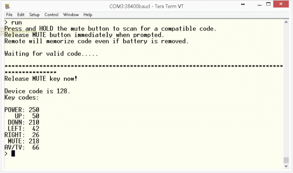

REMOTE LEARN CODE:
IR DevCode, KeyCode, IR_Int
Print "Press and HOLD the mute button to scan for a compatible code."
Print "Release MUTE button immediately when prompted."
Print "Remote will memorize code even if battery is removed."
Print
Print "Waiting for valid code....."
Print
If DevCode=128 Then
Print
Print "Release MUTE key now!"
Print
Print "Device code is 128."
Print "Key codes:"
Print
Print "POWER: 250"
Print " UP: 50"
Print " DOWN: 210"
Print " LEFT: 42"
Print "RIGHT: 26"
Print " MUTE: 218"
Print "AV/TV: 66"
IR Close
End
EndIf
Loop
End
Sub IR_Int
Print "*";
End Sub
TEST:
IR DevCode, KeyCode, IR_Int2
Print "IR keycode tester."
Print
Print "Press any key......"
Do:Loop
HUNT:
Do:Loop
End
Sub IR_Int2
Print "DevCode: " DevCode ", KeyCode: " KeyCode
End Sub
This code is nothing fancy at all, but it will help you setup the remote with very little pain.

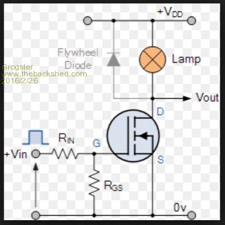

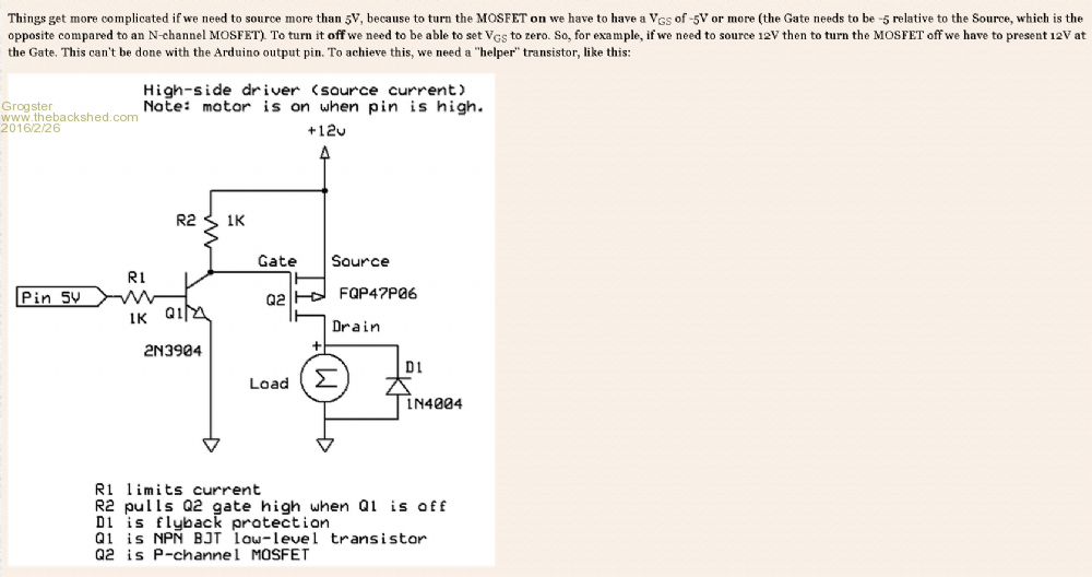

Posts: 10073
Posted: 02:01am 26 Feb 2016
As WW says, MOSFET's are gate things when you get used to using them.
Pun intended......
Low-side N-channel MOSFET switching is dead easy, but high-side P-channel switching almost always needs a blower transistor to help the gate along.
Low-side switch:
...and high-side switch with blower transistor:
Either of these will do equally as well as the relay, use less power to operate, and can pass surprising amounts of current with very little heat dissipation - that's one of many of the beauties of MOSFETS.
