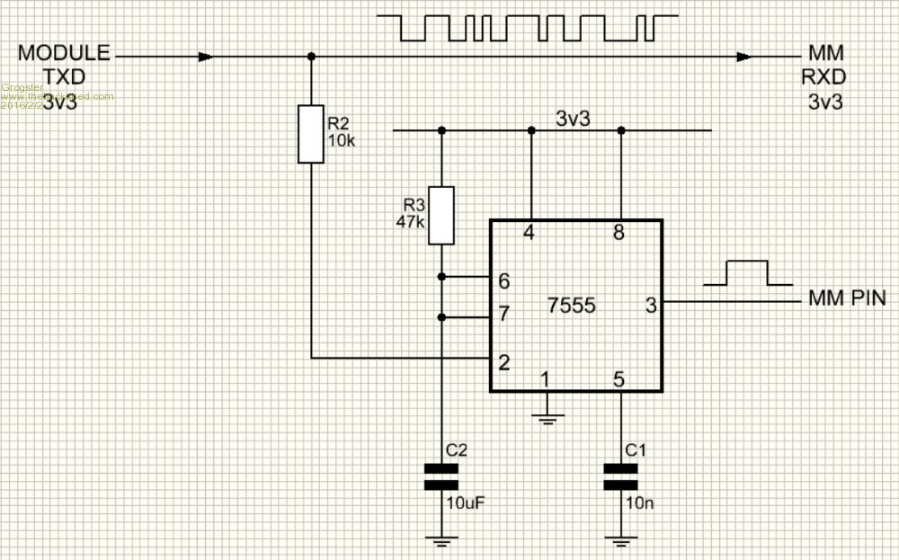

Past the serial ports, my thoughts hovered around the 7555 timer in monostable mode:
The idea behind THAT circuit, was that the serial stream from the RXD pin of the RF module is coupled to the 7555 timer via a 10k resistor, and for any given low-going pulse in the data-stream, the 7555 output will go high for the minimum time set by the RC timing components. All that is fine in theory, but I don't have any 7555's to play with, so can't bench test this idea. I plan to get some, but for right now....
I can then monitor the 7555 output via a MM pin, and simply wait for that to go low again, pause, check it again, and if still low, hop onto the network and send the message.

  Grogster said   The idea behind THAT circuit, was that the serial stream from the RXD pin of the RF module is coupled to the 7555 timer via a 10k resistor, and for any given low-going pulse in the data-stream, the 7555 output will go high for the minimum time set by the RC timing components.
Grogs,
What you're doing is often called pulse stretching, but it's not at all necessary. The MM looking for a minimum time in the idle state, all the while checking for a change to a non-idle state, will do the same thing.
Bear in mind I don't think there is any way to avoid signal collisions using this method of watching for the state of RX activity, no matter how you implement that function, it just makes them less likely.

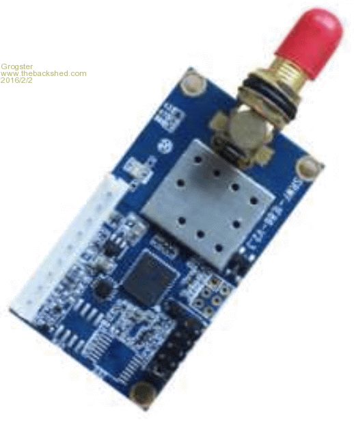

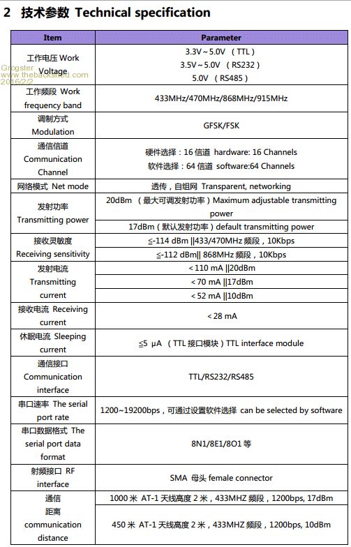

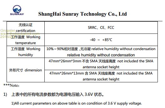

I am currently looking at playing with the Sunray RF 1E86 MESH module. It's not on their website, but I have some here, and have the PDF. If anyone is interested, I can put up a link to the PDF.
They too are about the same US$25 each, from what I remember when I bought some.
I sorta liked the idea of using the cheaper modules though, but then, the cheapest methods are often far from the best. By the same token, the most expensive is not necessarily the best either! Edited by Grogster 2016-02-03
