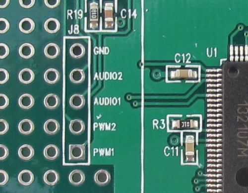

PWM does not work on my color maximite
The board does not look like the schematic
there are six pins and not 3 on the connector
there are six surface mount resisters and capacitors
hard to change
which ones do I need to change to get the PWM working if any?

There are several models of Colour Maximite around. Which is your one? Where did you buy it?

IIRC ........
The PWM uses the audio out .
The LP network used filters out
most of the ' PWM ness '
Enables ' TONE ' command : )Edited by hitsware 2016-01-01

On the CGCOLORMAX2, two of the PWM pins on that header connect directly to the microprocessor pins.
The other pins are "audio' and after the RC filter.
Edited by CircuitGizmos 2016-01-02

Wish it was that way on the ColorMax1 ...
