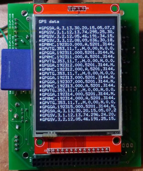

Has anyone (@matherp, maybe?) done full or partial scroll with a ILI9341 display?
http://rittle.org
Posts: 12057
Posted: 02:45am 25 Nov 2015
  Quote  Has anyone (@matherp, maybe?) done full or partial scroll with a ILI9341 display?
Can only be done by keeping a map of what is on the display in MM memory. You can't read from the display memory on the ILI9341 when using SPI for reasons I don't understand - could be just bad implementation of MISO on the ILI9341 boards.
It does have hardware scroll of the complete screen width (page 120 ) but this is limited in what it can do but should be programmable from BasicEdited by matherp 2015-11-26

If the display is in landscape mode the text scrolls sideways and you can go 1 pixel at a time. This is all the hardware can do.
Code below, tested on MM+ but should also work on uM2:

Also:
' Demo of scrolling text in a display - GPS monitor
option explicit
option default none
const fixedspace%=21
dim integer i,j1,j2,nextslot,scrollstart
DIM buff$,arg$(20) length 16
dim s$
open "com1:9600" as #1
cls
definescrollregion(fixedspace%,0) 'whole screen except top 21 lines, leaving 23 lines of 13 pixels
s$=chr$(0)+chr$(0)
i=controldisplay(&H37,s$) 'set the scroll area to normal
text 0,0,"GPS data"
nextslot=0
do
s$= GetGPSRecord$(i,arg$())
TEXT 0,nextslot+fixedspace%,s$)
nextslot=nextslot+13 'add in the character height
loop while nextslot<299 'loop until the screen is full (320-fixedspace%)
do
nextslot= (nextslot+13) mod 299
scrollstart=(nextslot+13) mod 299
j1=(scrollstart+fixedspace%) mod 256
j2=(scrollstart+fixedspace%) \ 256
s$=chr$(j2)+chr$(j1)
loop
end

twofingers
Joined: 02/06/2014
Posts: 1782
Posted: 02:59am 26 Nov 2015
Hi Peter,
I can confirm your second code works (P mode, MM2, BP170)!
Thats fantastic! And it offers new opportunities for the mites world!
Michael
