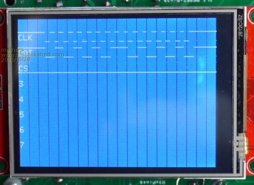

Using the same basic approach as for the oscilloscope, I've written the guts of a 8-channel (6 channel on 28 and 44-pin parts) 7.5 million samples per second (3 million of 28 and 44-pin parts) logic analyser.
The picture shows a capture of an SPI command "SPI write 2,&H55,&HAA" and is triggered on the negative going edge of CS. The example code allows labels for the channels to be assigned in a string array for display.
As with the oscilloscope, the same code runs on all Micromite variants and supports both SSD1963 (800x480) and ILI9341 displays.
Also as with the oscilloscope, I've created the guts of the application but it needs a GUI.

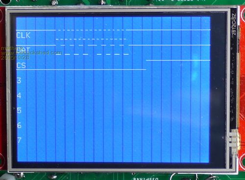

The second picture shows the same capture zoomed x2 and the start point scrolled
Drawlogic is the key routine. This allows one data view to be replaced by another using the same dataset very quickly by first erasing the previous data and then replacing it with new. A GUI could allow zoom-in, zoom-out, jump to location, scroll left and right all of which are supported

int j=0, l=0, x, y, ylast, mask, buffpos, lastbuffpos, multiplier=*scale,expand=1, lastmultiplier=*lastscale,lastexpand=1;
if(multiplier<0){ //decide if I am expanding or contracting the display
multiplier=-multiplier;
expand=0;
if(lastmultiplier<0){ //decide if I am expanding or contracting the display
lastmultiplier=-lastmultiplier;
lastexpand=0;
for(j=0;j<8;j++){//step though each track
mask=1<<j; //create the bit mask for this track
for(x=0;x<HRes;x++){ //step through the screen
y=j*25*(VRes/240)+VRes/12;
if(mask & *tracks){
if(expand){
buffpos=x*multiplier + *startrecord;
} else {
buffpos=x/multiplier + *startrecord;
if(lastexpand){
lastbuffpos=x*lastmultiplier + *laststart;
} else {
lastbuffpos=x/lastmultiplier + *laststart;
if(buffpos< *count){
if(*startrecord!=*laststart || *scale!=*lastscale){//delete last trace if track is enabled
if(cbuffer[lastbuffpos] & mask){
DrawPixel(x,y,0xFF);
} else {
DrawPixel(x,y+VRes/16,0xFF);
if(cbuffer[buffpos] & mask){ //only draw if this track is enabled
DrawPixel(x,y,0xFFFFFF);
} else {
DrawPixel(x,y+VRes/16,0xFFFFFF);
Edited by matherp 2015-10-29

Absolutely BRILLIANT
One question: On a 64pinner, are you saying 7.5 million samples/s equates to just under 1MHz per channel? If so, is there a potential for higher sampling? And if not at CPU 120, would this increase the samples/s?
Haven't finished reading your post yet so apologies if answer is within your post
WW
Posts: 12083
Posted: 05:22am 28 Oct 2015
  Quote  On a 64pinner, are you saying 7.5 million samples/s equates to just under 1MHz per channel?
No 7.5Msps on each and every one of the 8 channels at 120MHz Edited by matherp 2015-10-29
