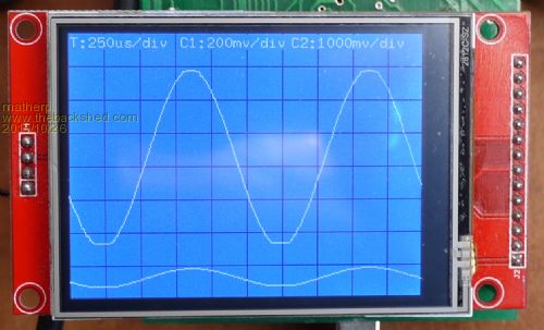

Here is a version of the oscilloscope code to run on a 28 or 44-pin Micromite with a ILI9341 SPI connected display. The display must be configured in landscape or reverse landscape mode.
The uM2 can't quite make the speed of the MM+, not because of the ADC, but because the code can't store the data fast enough without missing ADC inputs. In fact the MX170 ADC seems less noisy than the MX470 so the trace is cleaner.
All the usage is as per the original thread but I kept this one separate as there may be a bigger audience for the 28 and 44-pin chips

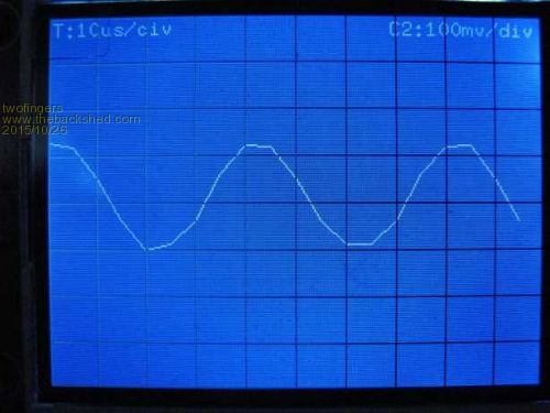

Hi Peter,
this is absolutely fun-tastic! (You made my day!)
I did not dare to ask you about a uM2 version.
For a first experience I used this slightly modified code.

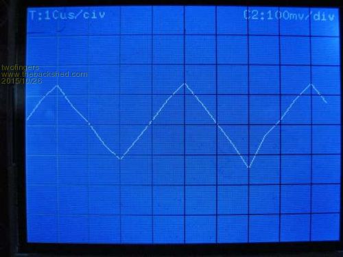

With a 25KHz signal on PIN23 (only) I got this pictures, very nice!
But this is just a first step ...
May I ask you about the C source? Perhaps I'm able to learn something.
Thanks a lot!
