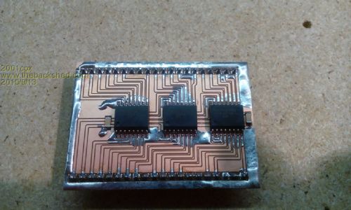

2001cpx
Joined: 03/10/2013
Posts: 59
Posted: 10:36am 13 Sep 2015
Here a Small Board i,ve made With My CNC,
DIL40 Sfm 8574
24 i/o ,need 25 ....
added 1 more chip,but with 7 i/o lost...
I think i will call 7 inch display,to use With Micromite,
it's possible to have Micromite with VGA out? found nothing abot this
